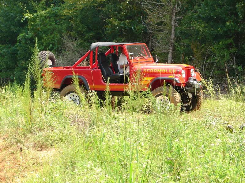

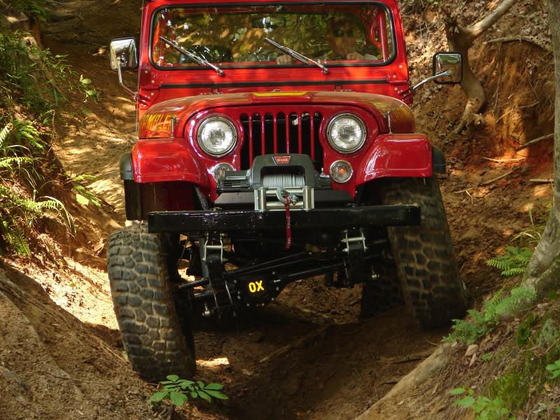

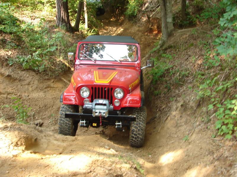

Pictures of the Scrambler being used on a trail ride a few weeks ago. First two picture shows the winch in action.
Looking good. Is that where you almost rolled it? Do you store the softop in the special pouch once you get where you are going or just have that sweet looking bikini top which by the way looks to fit great.

Yep, almost went on its side. The pic doesn't make it look too bad, though:crazy:
The YJ strapless bikini top I "borrowed" fits on the Scrambler perfect. The short straps reach around the larger Scrambler roll bar just fine. The straps only have about 2"-3" of excess after you run them through the turnbuckle things, but this style bikini top will work on a Scrambler. It clears the Rock hard In Cab Roll Cage just fine, too. Fits tight with no flapping.
Since this trip was only to Jackson, MS, I did not take the 1/2 top with me. I finally replaced the one damaged snap that was on one of the storage bags straps, so now the storage bag is functional. If the 1/2 top is not on the Scrambler, I try to leave it spread out in the garage on a close hanging thing, so it does not get wrinkled up. I have not actually tried to roll it up and put the top in the storage bag yet. I will update when I do:wave:

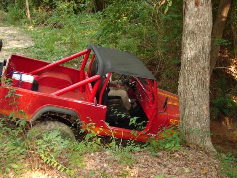

Hang time
That pic looks pretty scary.
Looks like U had some pucker time with off camber and tires in the wash out.
What were U thinking the whole time? :fingerscrossed:
Basically, I was hoping for:fingerscrossed::fingerscrossed:, but in the back of my mind I was thinking, "Well, it is definitely about to get broke in":eek:

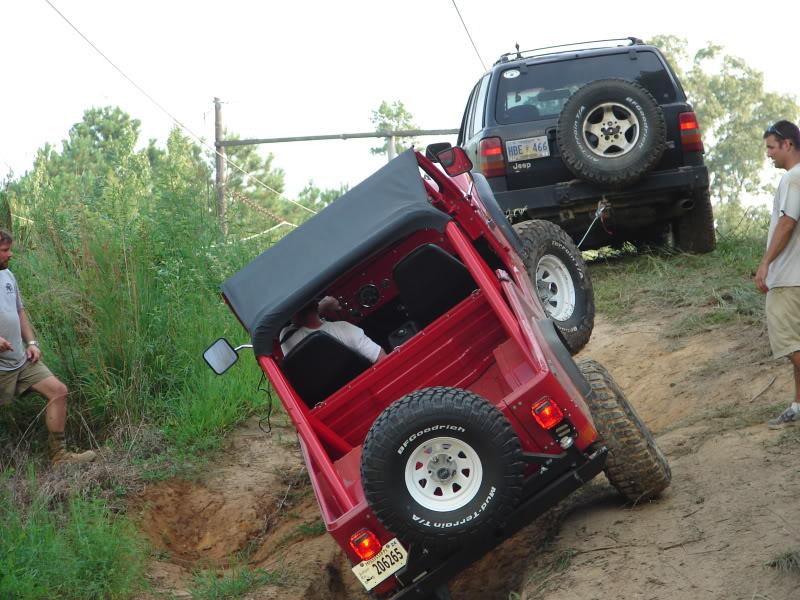

I stopped climbing because the passenger side front tire kept getting higher and higher off the ground as I moved forward. I was actually a little bit farther up the hill, with the passenger side front tire way higher, when I decided to stop and winch it. At the highest off camber spot, I could extend my arm about 1/2 way and touch the ground. That's when I decided that i went about as far as i could go without flopping over:crazy: By running the winch to the passenger side, it helped force that side back down, and the rest of the way up was worry free:woot:
Fuel Injection performed flawlessly the whole time:D
