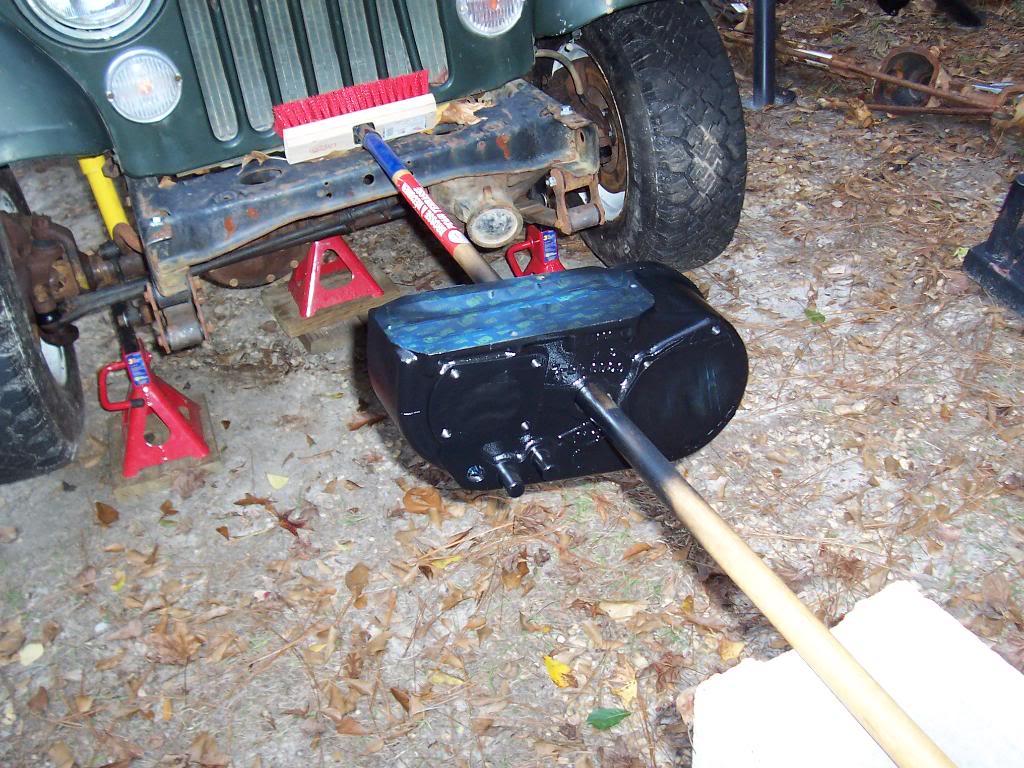

Last weekend I took apart the yard Scrambler's transfer case. I had to modify the stock case by grinding a notch in the metal of the case that surrounds the inspection plate. The notch must be cut into the case in order to get the idler gear to fit into the case upon reassembly. This is because two of the replacement gears are larger then stock, so the idler gear is going to require some extra space to fit back in. The instructions are not too clear about how big of a notch to cut, hopefully my notch is big enough. I wont know until the last step of reassembly. If the notch is not big enough, time to take the case back apart.
Picture of the modified case after a thorough cleaning and repaint.

Just a quick thought, why paint this stuff black? People do it in the engine bay too. Doesn't it make it next to impossible to spot leaks? I painted my tcase a light grey and always liked that the engine bay was white (just the scrambler's color) for the same reason. I spotted a leaky seal on my old 258's dizzy because I saw the fresh oil on the white.
Of course, if you're just sick of seeing leaks, black would be great :D but if you're rebuilding, why not do something so you could catch any future issues earlier?
Just something that's floated in my head and came popping up when I saw your paint setup (very cool way to paint it BTW :thumbsup:

Yep, the paint stand is the bomb:D
I painted my whole jeep body the same red color, including underneath and under the hood. I don't like black under the hood, either, unless the rest of the jeep is black:twocents:
I just like how black looks on the transfer case. They look "funny", IMO, when people paint them different colors. Leaks would show up better on a different color, though. I do leave the aluminum housings that bolt on to the transfer case the natural aluminum color, I like how it looks:cheers:
