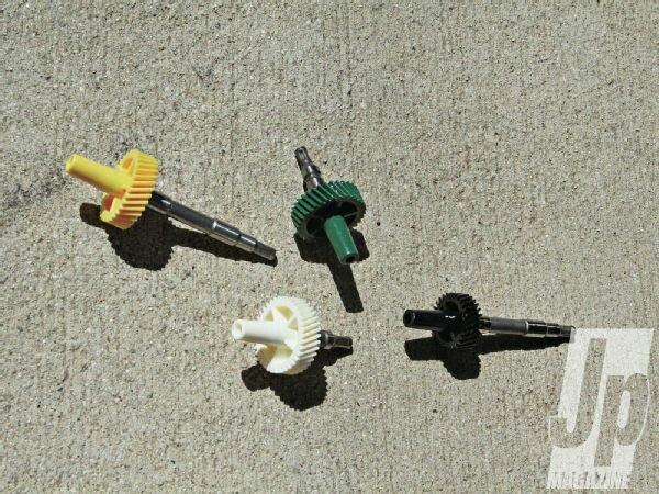

On the Dana 300's I have rebuilt, I always just changed the plastic speedometer gear to get the speedometer reading correctly. On the Dana 300, you do not have to disassemble the transfer case to change the plastic gear, they can be changed easily while the transfer case is in the vehicle. IIRC, one bolt holds the gear holder thing in place, then you can swap gears. You do have to clock the gear holder piece the right way in the case, depending on the gear used.
If it's not a Dana 300 that you have, I am not sure how the process works, but should be similar :shrug:
Why not just get the right color speedo gear. Its cheaper then that unit ..Unless your changing gears and tires that often. . Its take 5 minutes to change and its on top of the tcase. No need to open the case..

Thanks guys, from what I've researched I thought two gears are required, you buy them as a set. I have wondered about the rotation of the part in the D300 but that again needs another part. I gotta get researching.
Its one gear just have to pick your gear tire combo..
Sent from my SM-N910P
Ooh. Ok I'll get onto it. I'm a dimwit. The green one will match the truck 🙃

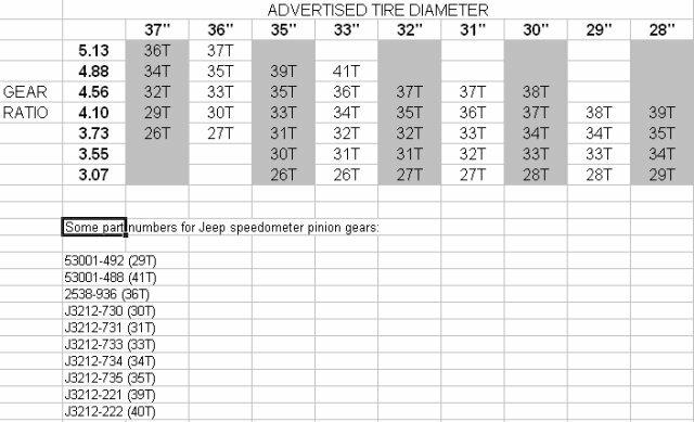

Does that truck have a Dana 300? The gear and gear housing are all you need, and more than likely you can use your existing gear housing. 21-25 tooth housing is the oddball, and then the other goes from 26 all the way up into the 40's and you orient it at 90 degree intervals depending on which gear you are using.
I will guess that you already have the right housing, and would just need the gear.
http://www.ebay.com/itm/Mopar-A-B-E...ash=item58dce7fd13:g:gYoAAOxy2CZTZwgQ&vxp=mtr
Thanks Will. It's a 208. I'm out of town but when I get back I'll crawl under in get into it. I understand it all now. Dyno next week so I'll see exactly what my error is and use the chart above to get my tooth count. Might be 26
