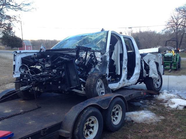

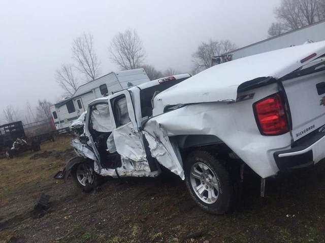

It's a 2016 Chevy 1500 Z71
It has a direct injected 5.3 with a 6l80, And it was wrecked about as bad as I've seen. It went through the trees at a high rate of speed. They said it took about six trees to stop him. And he WALKED away.
The only damage I've found so far is the oil filter was ripped off, so it may need a new oil pan.
The plan at this point is to work on getting it fired up, then work on wiring and install parts this summer. That way next fall I can install. :smokin:
