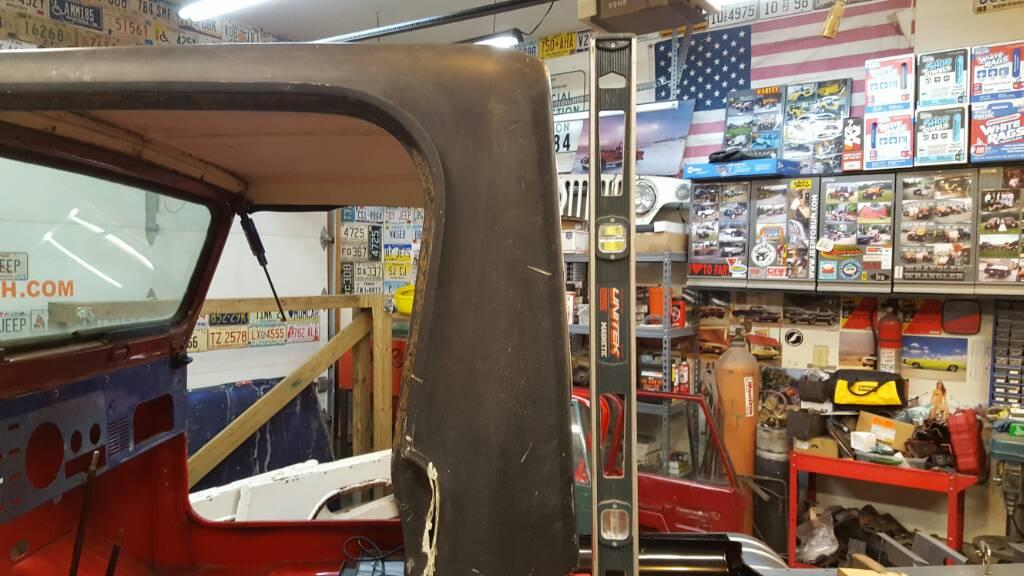

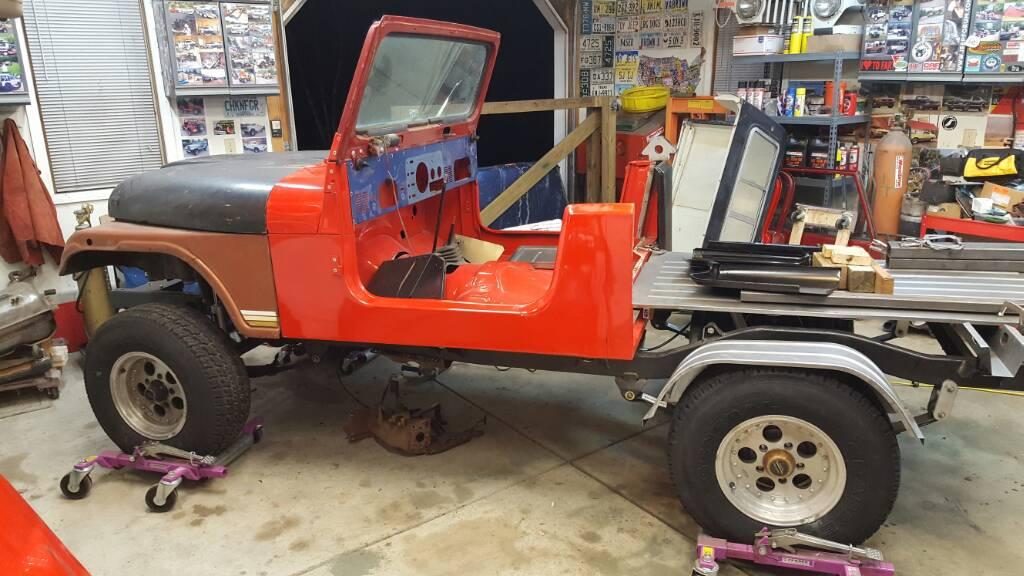

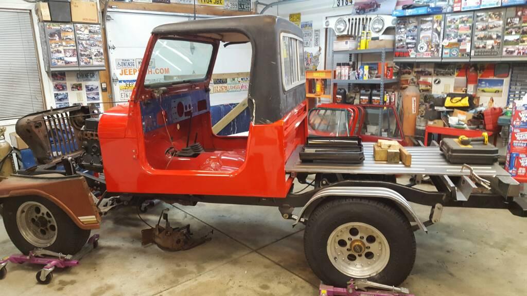

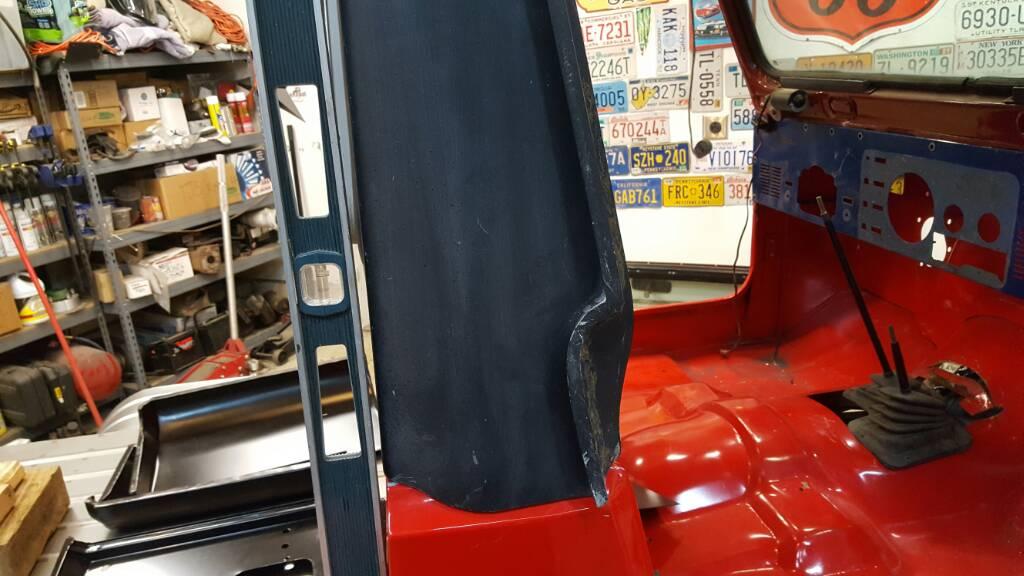

So, last night I got to measuring and leveling and seeing what is what... I wasn't overly impressed when it came down to the end of the night.

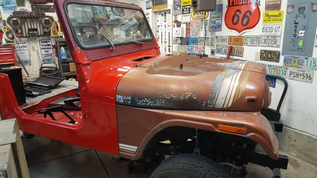

I was hoping for a good starting platform, what I have found is what appears to be an early MD Juan front clip with no welded nuts for the dash panel or the hood hold down.

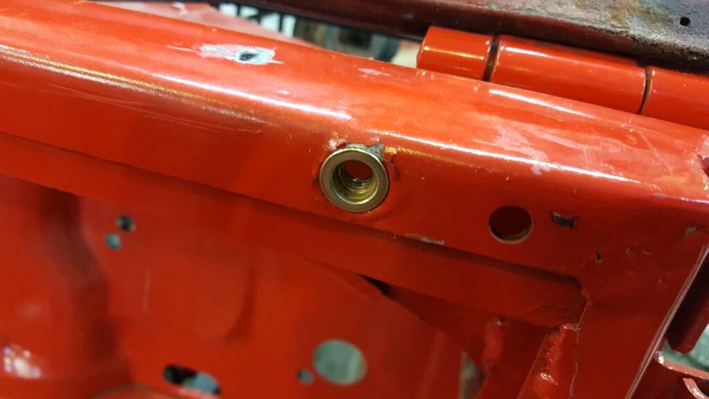

Up front, there are handmade hood rod extensions that push the grille out too far, the Fender holes are just holes, so nutserts are needed.
Then on the backside, it is a bit lopsided and uneven.
Then my drill broke.
Then I had some beer.
New drill will be here Friday, I won't do much until then.

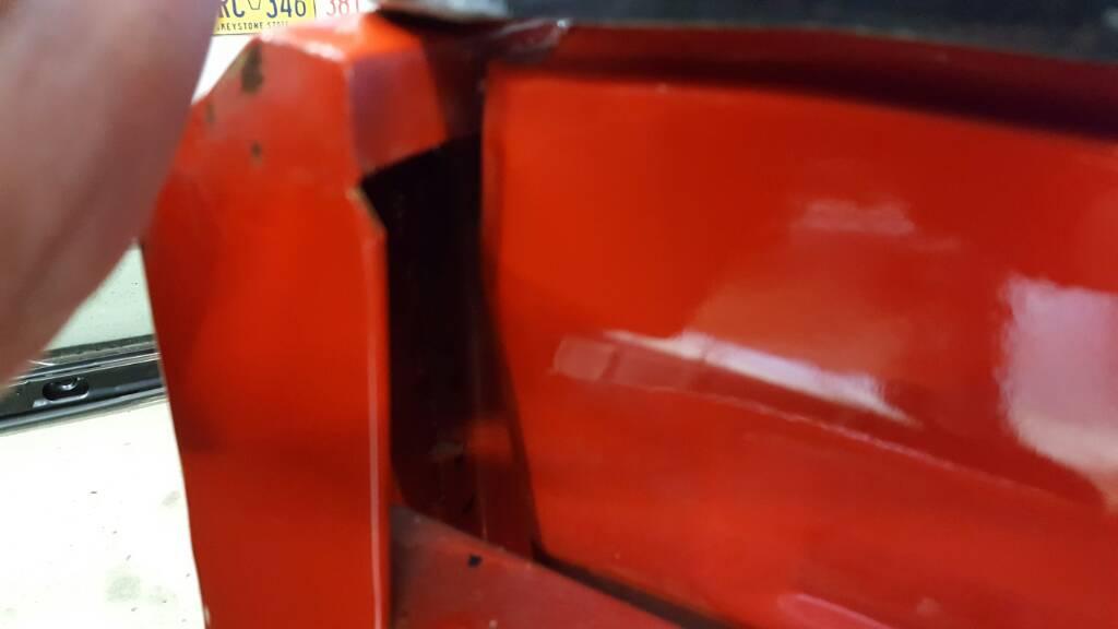

There was an inch on this side.
There was no inch on this side where the bulkhead meets up.
Level from side to side isn't great
I will be removing the bulkhead and back bracing and will put corners on to close in the bed, I will have to rectify the 57.5" front to back vs. the 56.75". :(

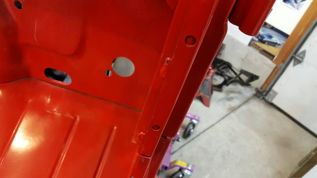

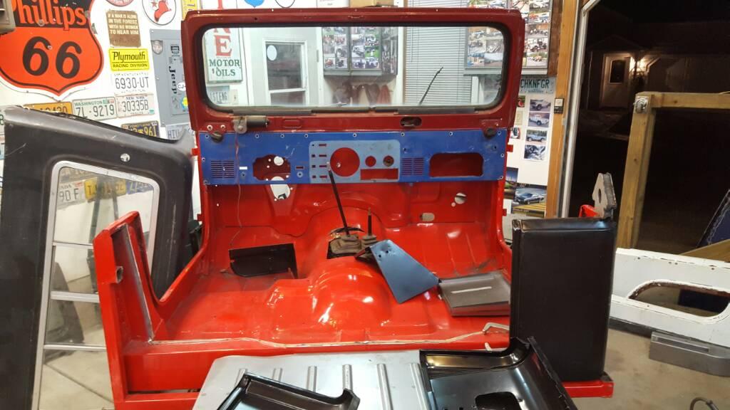

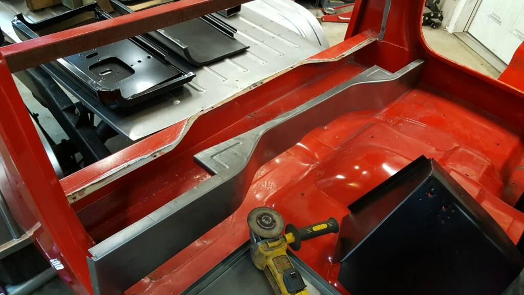

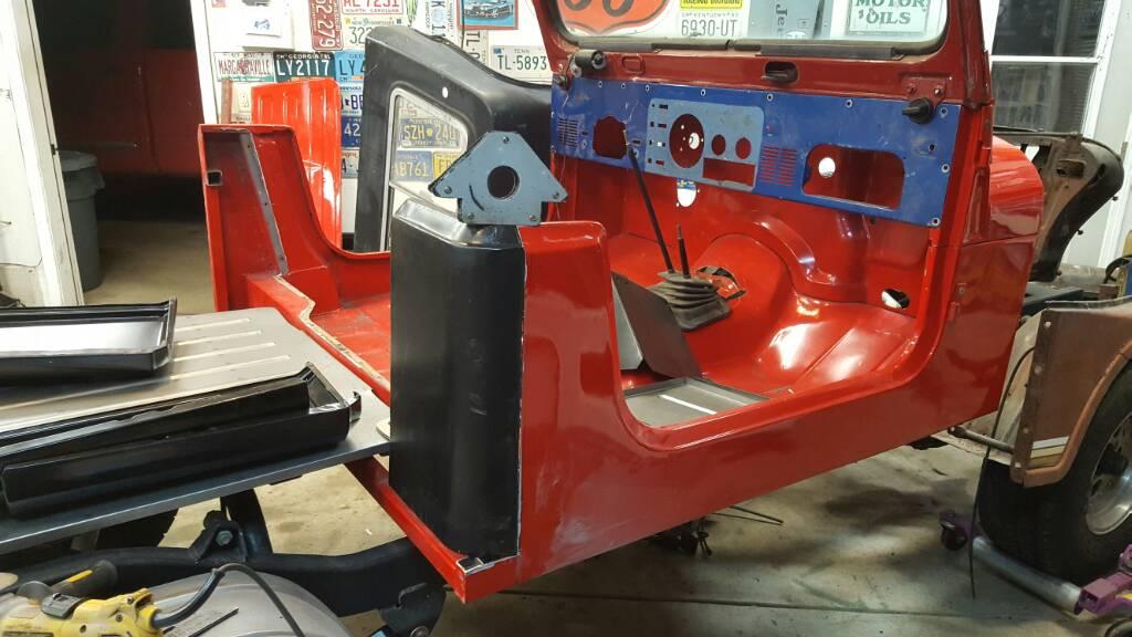

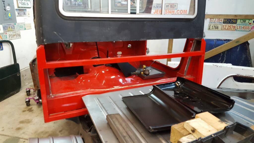

So, onto the bulkhead extraction... previous owner like the tack welds and must be heavily invested in silicon... also 2 of the bolts in the bpillar were stripped out, so that was a fun few hours!
I have a new step up piece that I will use to put it back to "stock"ish configuration... you can see how it is reversed from how it normally is.
I am enclosing it, so, new side corners and fab work soon.

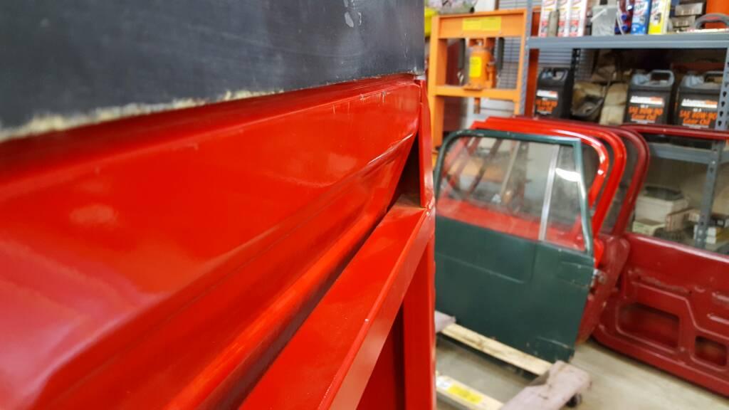

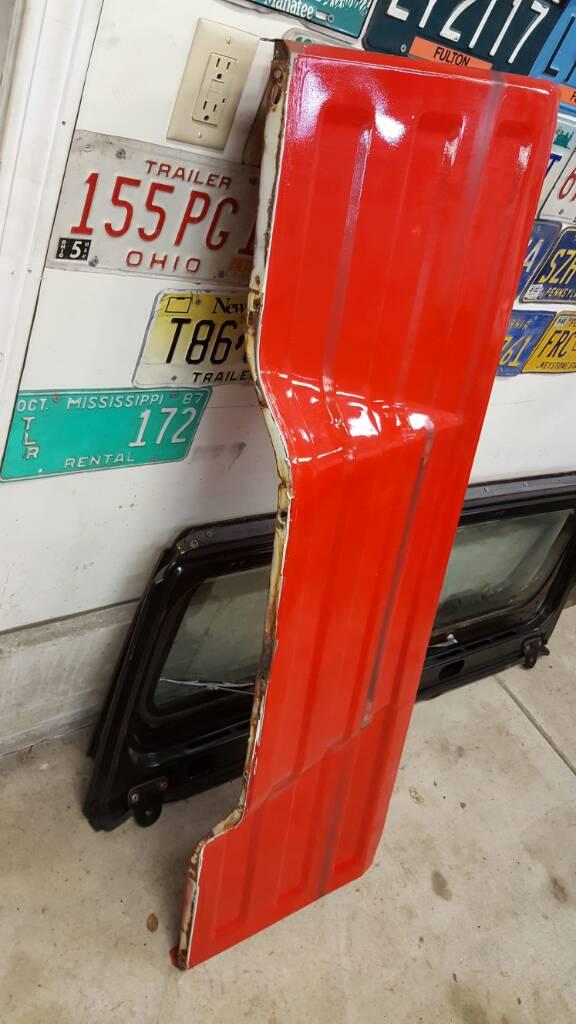

So, what do you do when you buy something and it isn't quite right? Cut it of course!
If you notice, the doors are open (both garage and side)... this thing was full of bondo where the transisition to the custom rear piece was and it smoked me out of the garage.
It was like 25 degrees out as well, so not too bad, but didn't last long last night... long day at work and was tired.
I will end up cutting it all out and repairing it all with new b pillars and those rear corners... well not THOSE rear corners... they aren't the best.
Side note... I got a set of Crown and a set of MD Juan ones... the Crown ones are thinner metal and the MD Juan are thicker, but the bends on the top aren't even comparable.
I will get a side by side comparison, but man, things are quite different from one to the other.

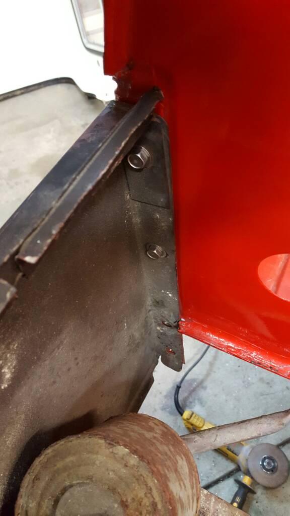

Last night rivnuts and nose

Rivnuts? i just reached around and used nuts and bolts when i bolted my fenders on my MD Juan tub, arms like Mr Tickle me:D
