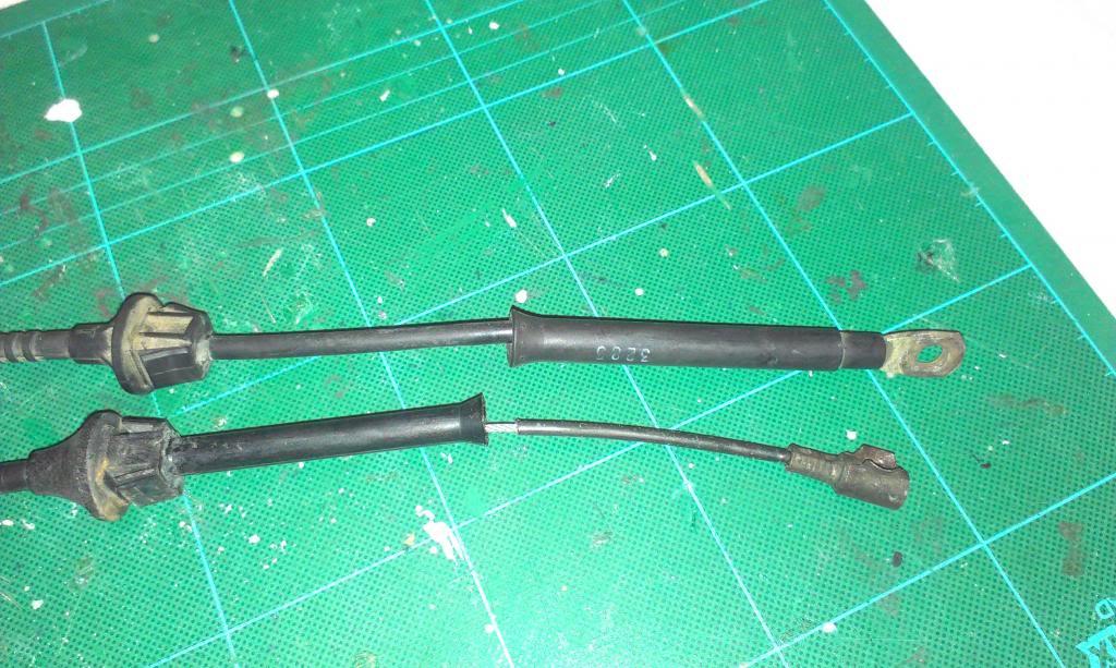

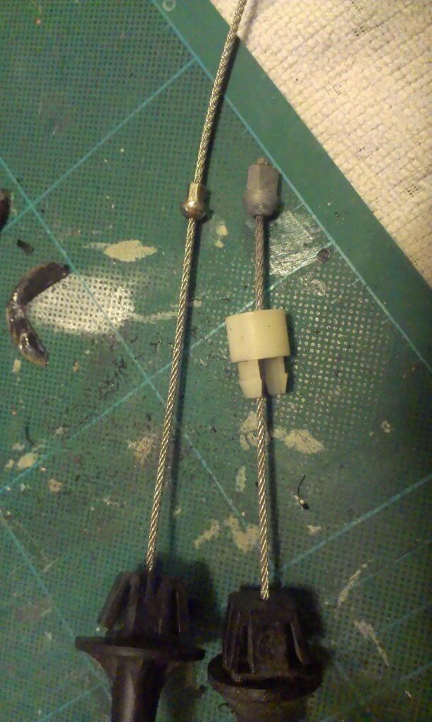

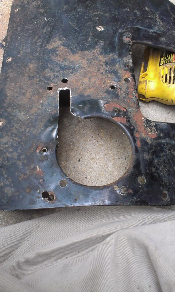

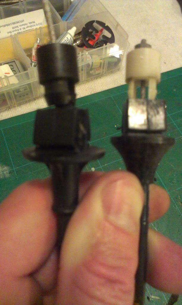

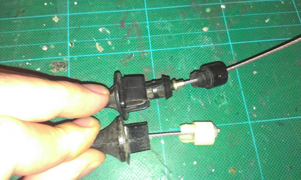

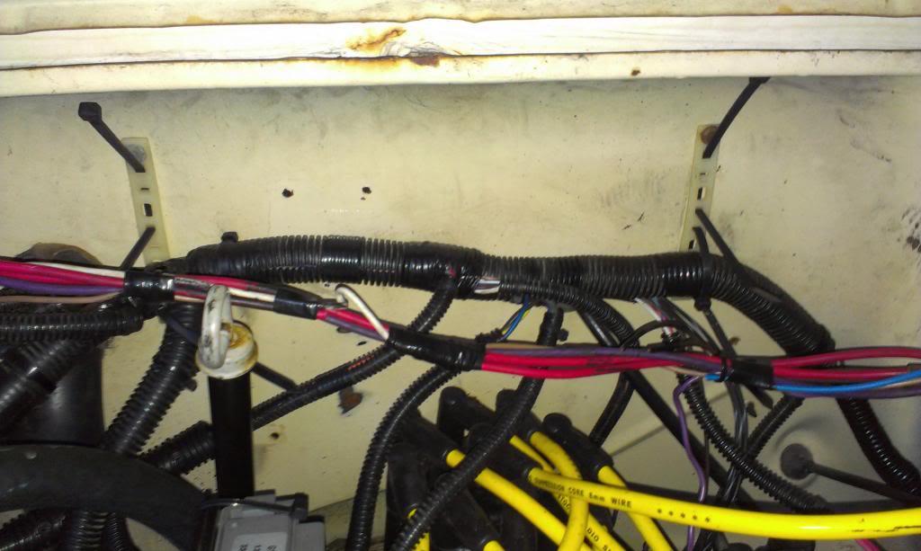

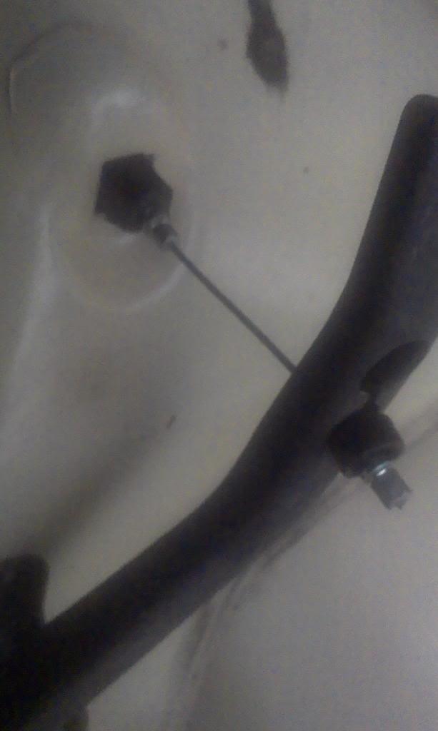

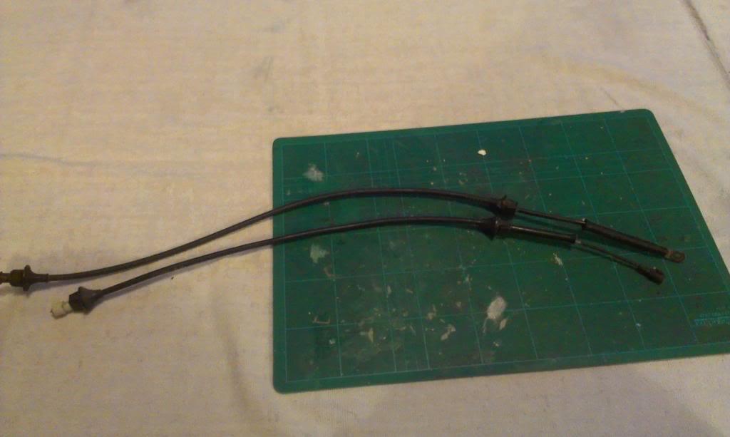

I picked up a replacement throttle cable from NAPA, it is about a 1/4" longer. I trimmed the plastic around the square block that goes into the fire wall, fits good.

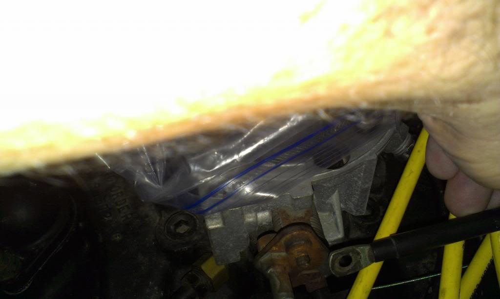

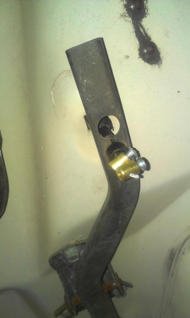

Ok, it fits fine. The picture above shows the throttle against the idle stop, and the pedal is hanging loose to the floor. So, I just needed to slide the cable stop toward the firewall. The cable stops on these cables are the "permanent crimp" kind, so I can't slide it.

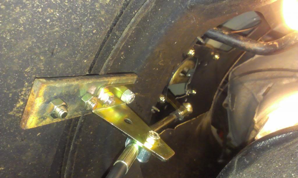

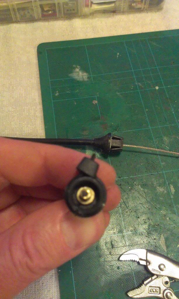

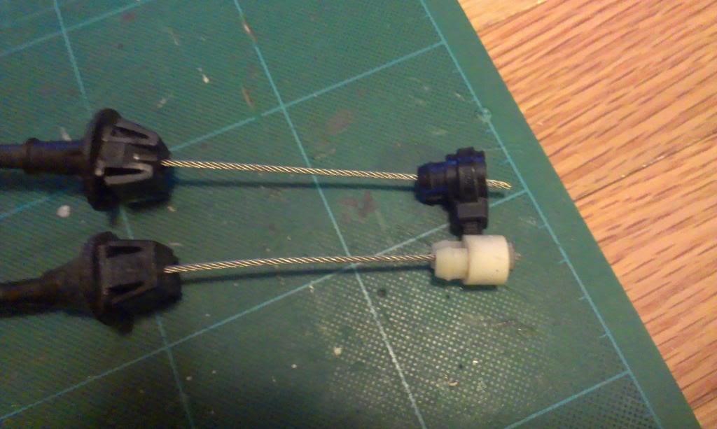

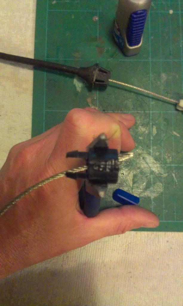

Bought these, drilled the holes out to 7/32" to fit tight on the cable.

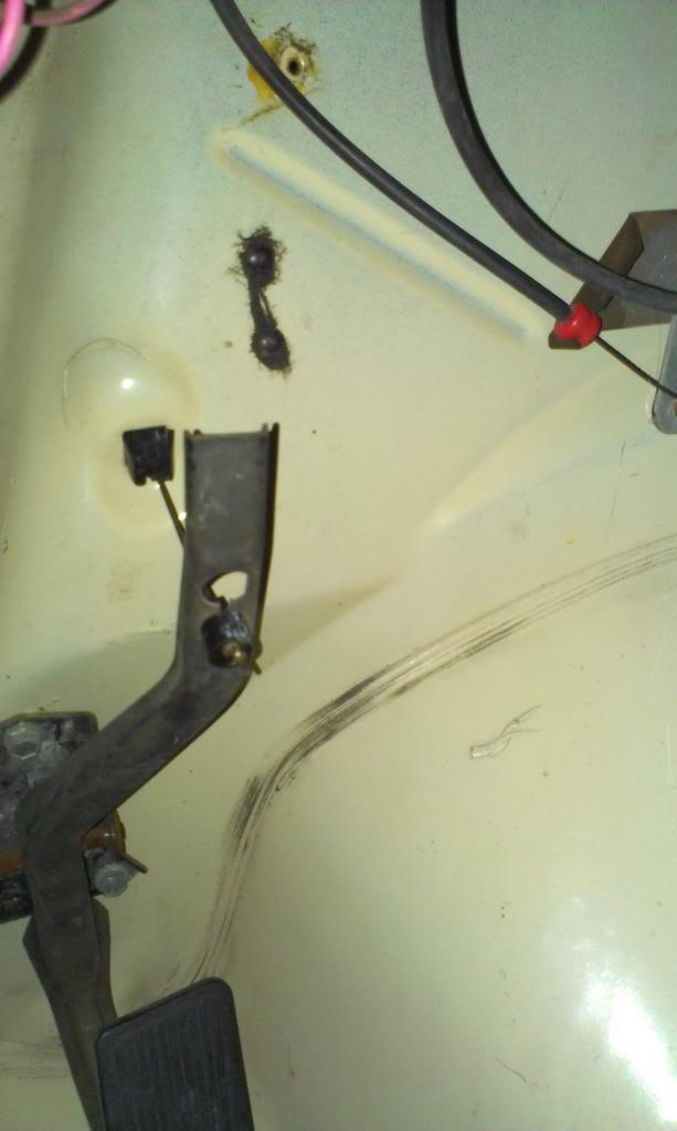

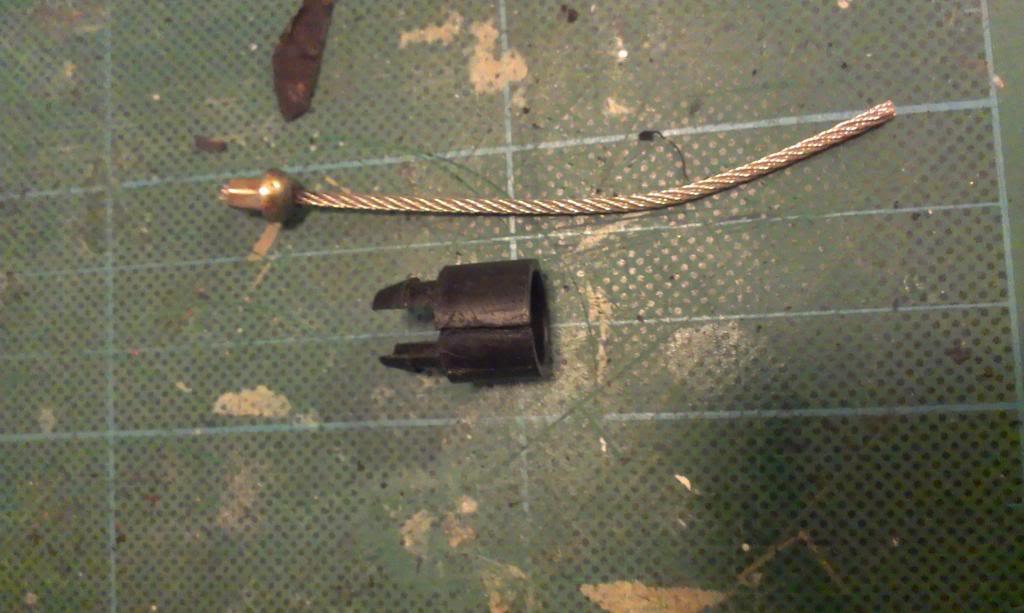

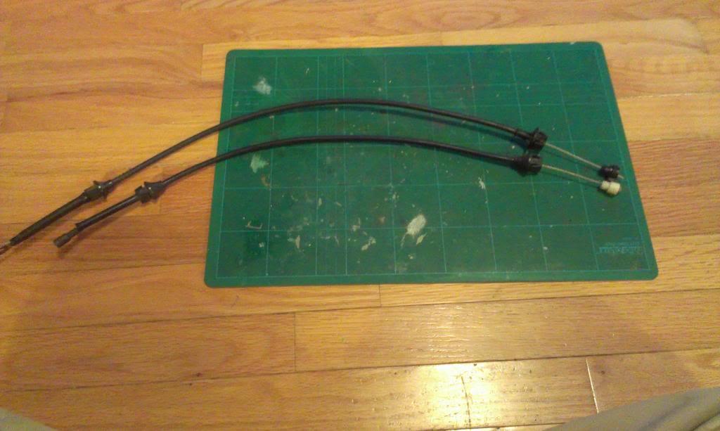

Cut the crimped on cable stop off, and installed the above screw stops, I now have a working gas pedal.
Looks kind of "ghetto", but it will work for now. I would love to find a local place that could crimp on another permanent crimp cable stop. But for now, it works.

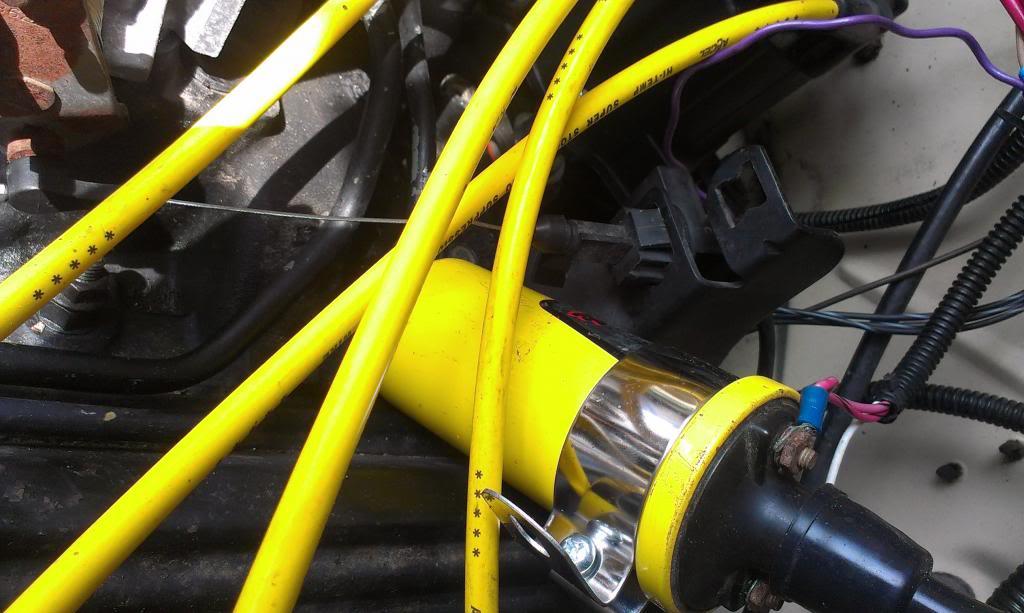

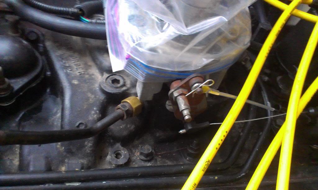

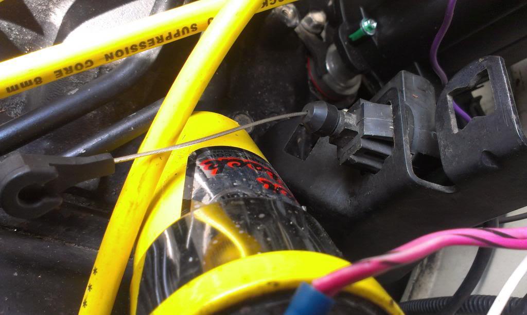

And the cable hooked to the TB, I need to find the "correct" throttle cable clip at the junk yard, but the little clip works for now.
With my above throttle linkage, I get 100% WOT with the pedal, so it is good to go, except for my ghetto cable crimps.

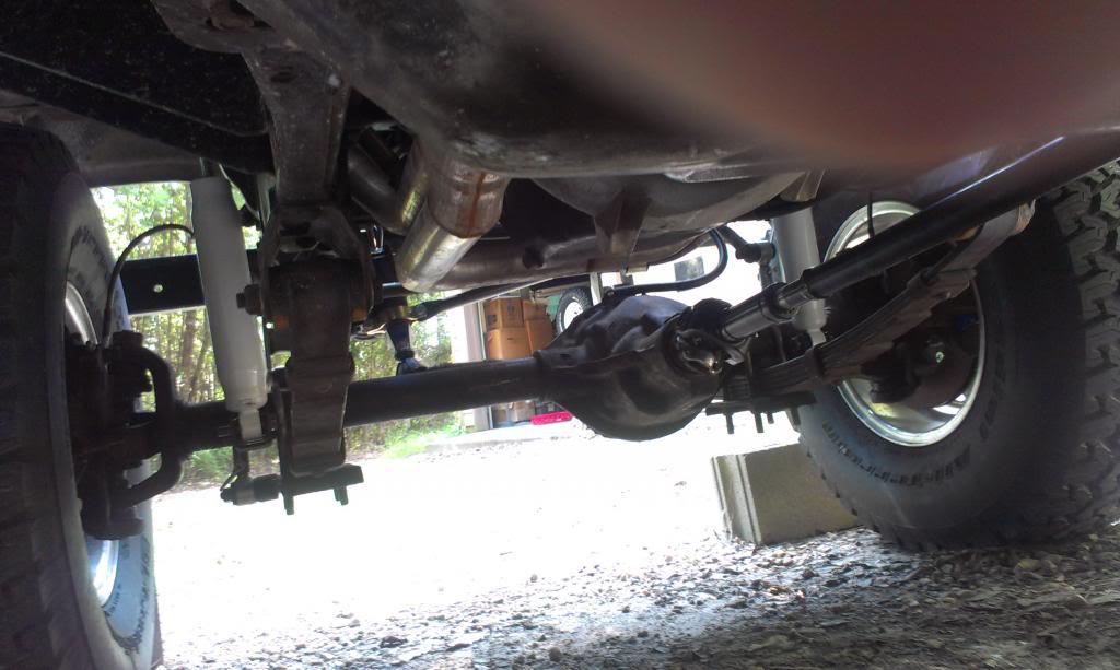

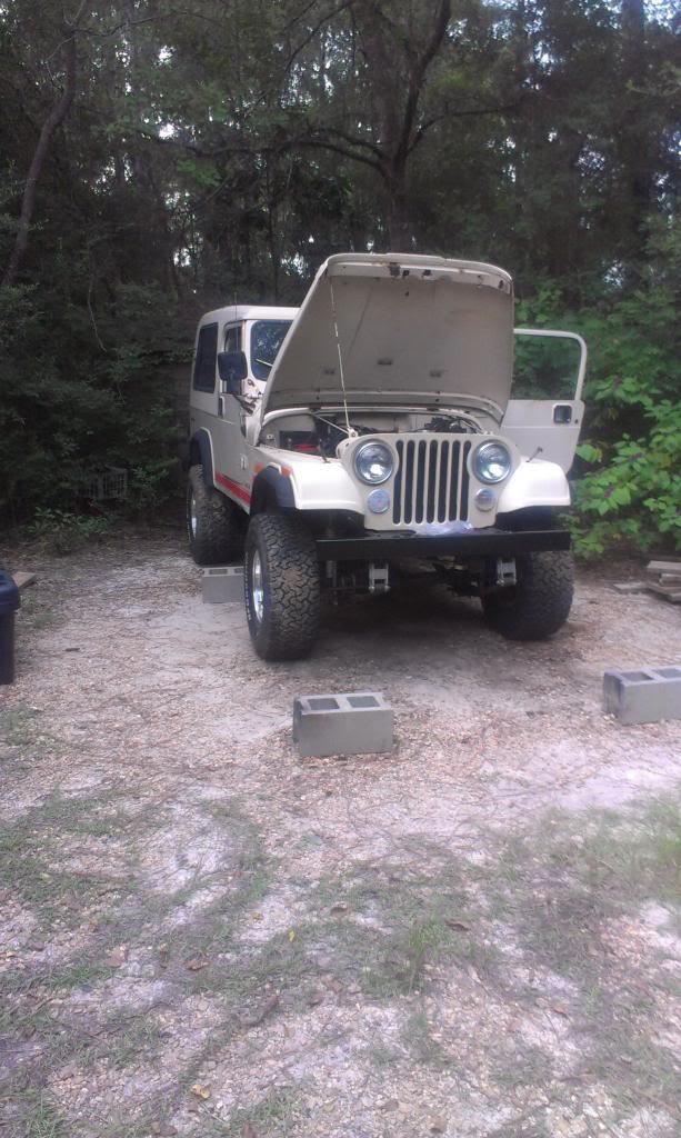

Once I got the gas pedal working, took it on a "reverse only" drive, and it moves, at least backwards for now.
Just to prove it move!!!! (note the cinder block wheel chocks)

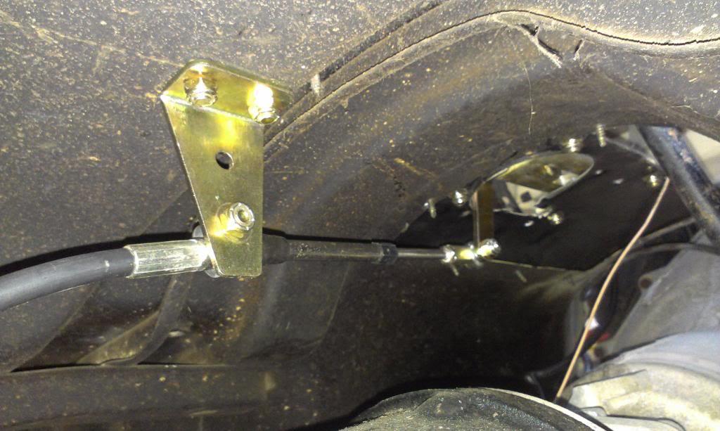

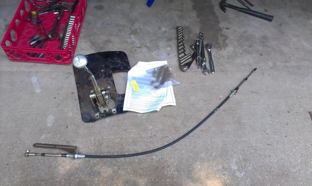

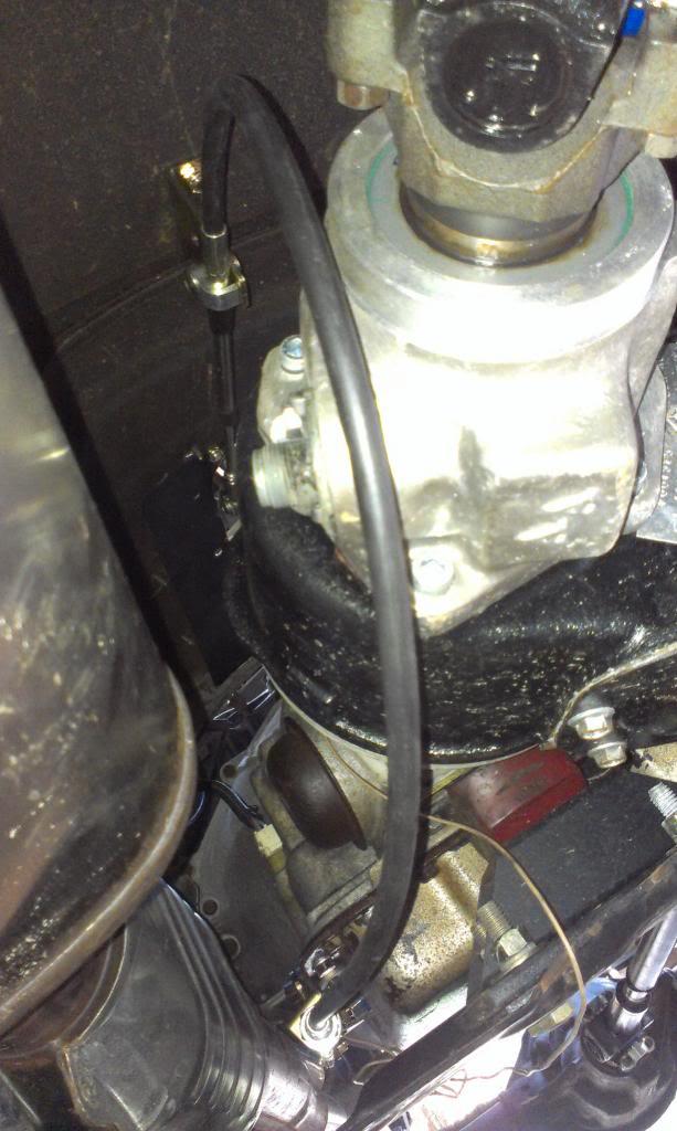

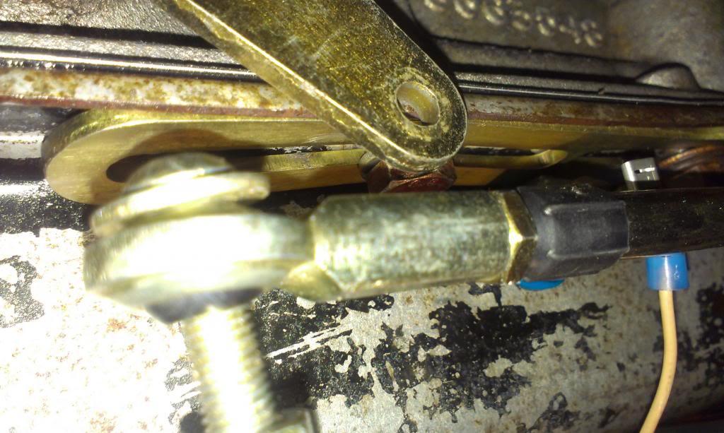

I disconnected the cable from the selector shaft, and shifted the transmission by hand. I can get all gears this way, so no internal transmission issue. So, I hooked the cable back up, shifted it to Neutral, and took a look. Turns out, I did not have the cable ran/mounted/adjusted correctly.
In the above picture, the shifter is in Neutral. Note how the jam nut is against the black part of the cable, the cable can not be pulled inward anymore, so it wont shift past Neutral.

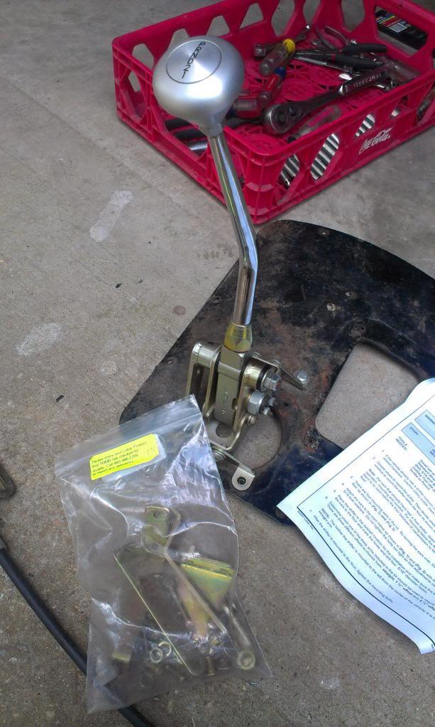

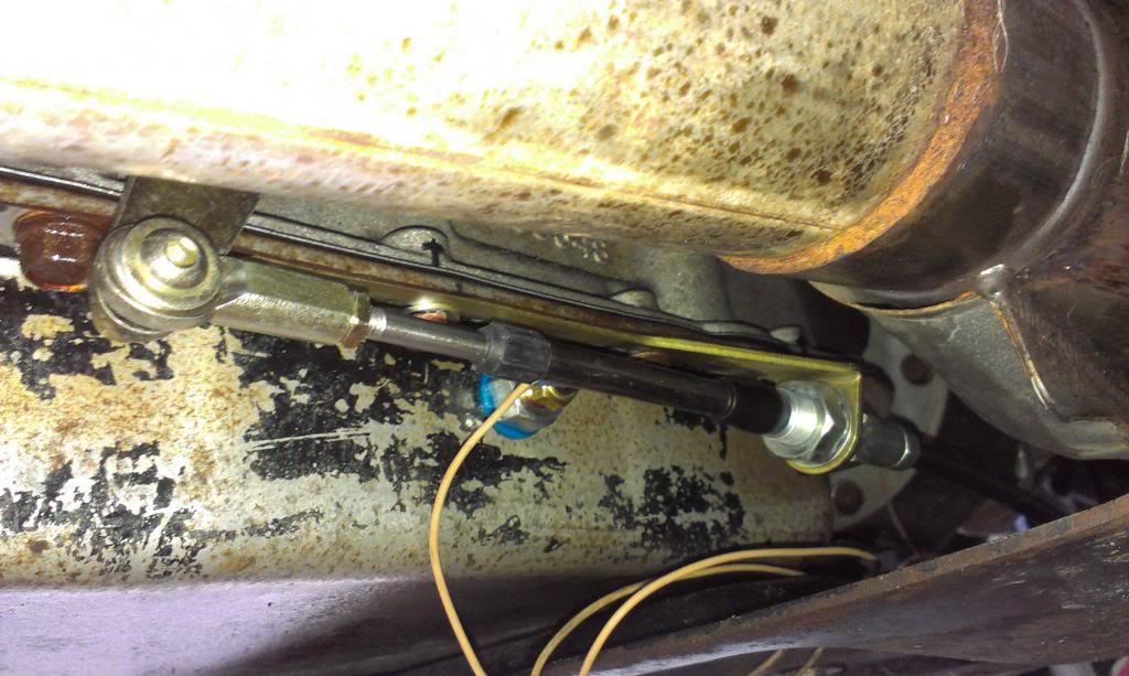

I can fix this issue, but I have a bigger issue: The Lokar supplied selector shaft bracket/bolt on the cable method will not allow me to shift past Third.

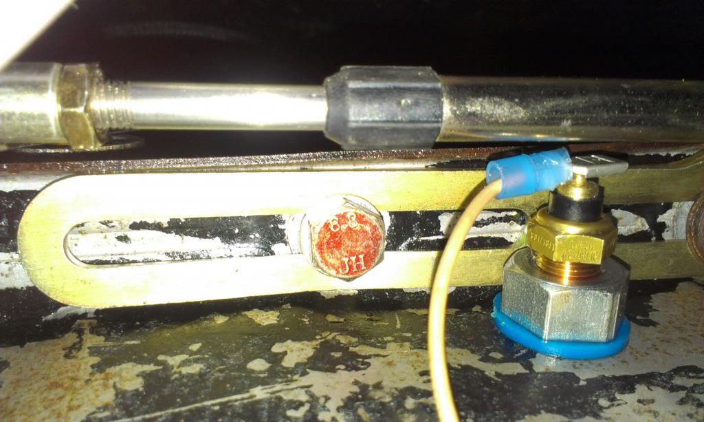

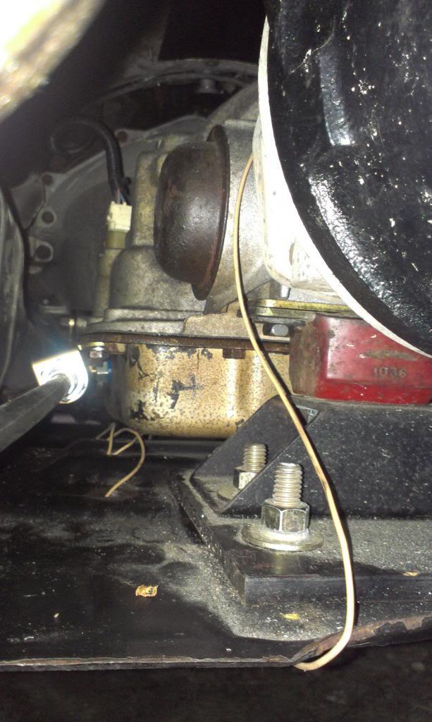

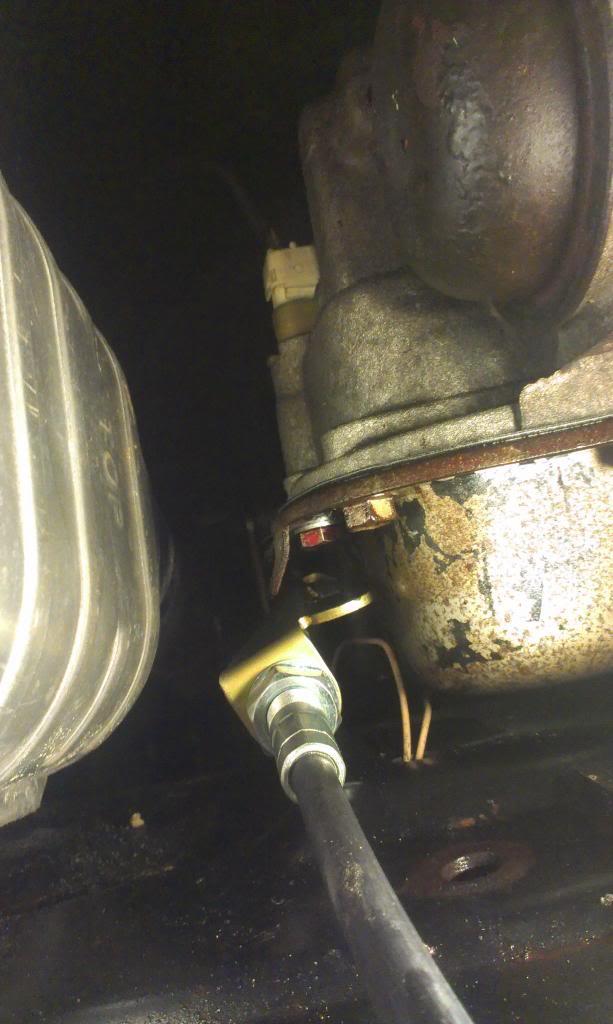

In the above picture, note the gold colored selector shaft arm. It sits flush against the transmission pan. There is no room for a nut between this arm and the pan. The instructions say the arm must be mounted downward, and it does, for the cable shifter to work properly. For now, I can bolt the cable on and get down to "Drive" and "Third". But, wont be able to shift manually to "2" or "1". My plan: I am going to weld a nut to the outside of the arm. That way, I can thread the cable attaching bolt to the nut, and wont have anything sticking out on the backside of the selector shaft arm to hit the transmission pan. I might call Lokar, I wonder if this kit just came with the wrong selector shaft arm?? I thought about bending this arm outward, then back down, to gain clearance for a nut on the backside. But, if I do this, I will effectively "shorten" the arm, and it might not work. For now, if I can get this thing to shift into drive, I will be happy. The fix to get the other two manual gear selections wont be too bad.

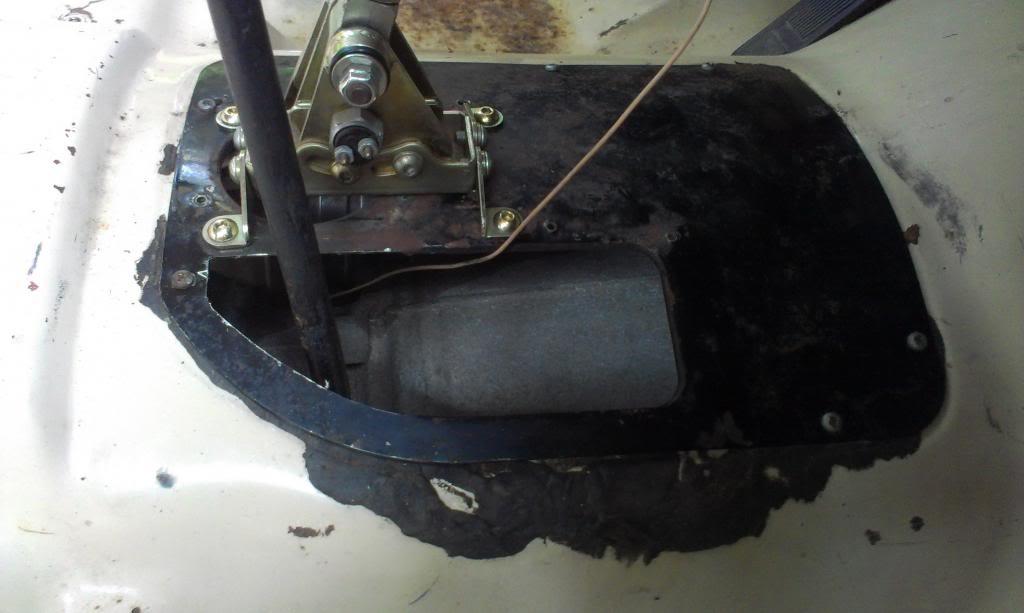

This shifter cable issue is partly my fault, no doubt, but the instructions are wrong, too, IMO. I mounted the cable bracket to the two pan bolts it says to use, and the cable is too far forward. So, I am going to slide the "gold colored transmission pan mounted cable attaching bracket" backwards, so that I gain more clearance between the selector shaft arm and the end of the cable, so that I gain the necessary clearance for the cable to operate through its full range of motion.

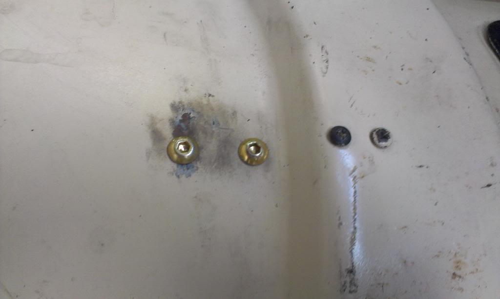

And of course, I can't just slide the bracket rearwards, because I left the stupid little metal "tang" on the pan!!!!! (bent outwards next to the red bolt head)
I was able to get the Dremel in there, and I cut the "tang" off, so no big deal. Now the bracket is where I want it.

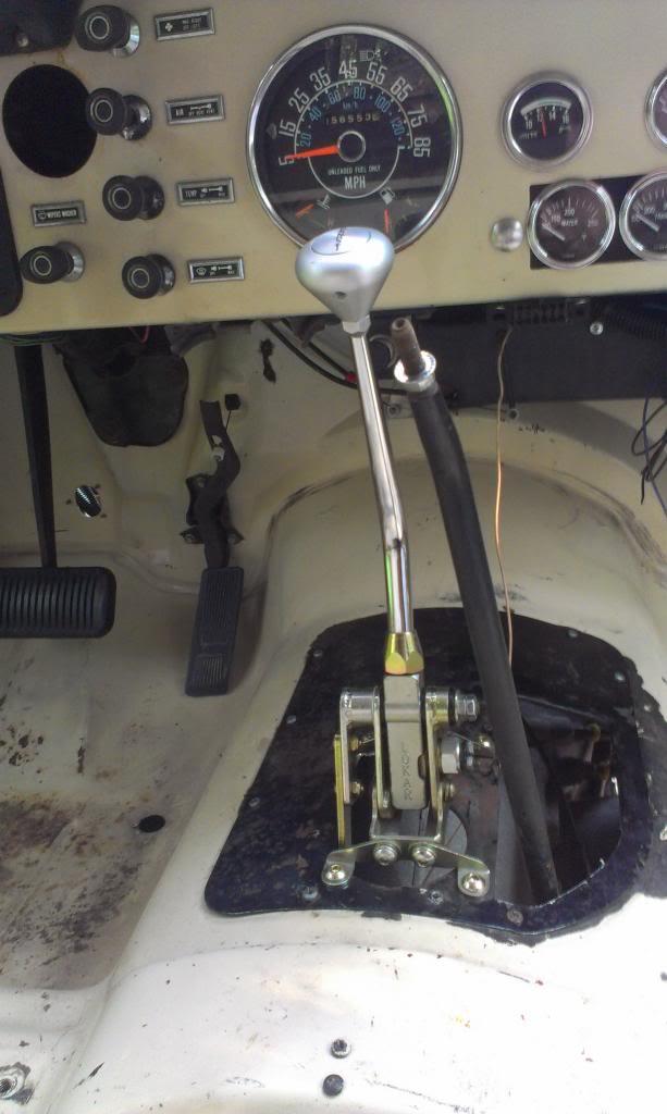

I am also pretty sure that I have the "floorboard mounted rear cable stabilizing bracket" mounted too far back. I do not want to drill anymore holes in the floor to move this bracket forward, so I will make a plate bracket to slide this bracket closer to the shifter. Shouldn't be too bad.
I "think" I have the shifter figured out, maybe!!!
