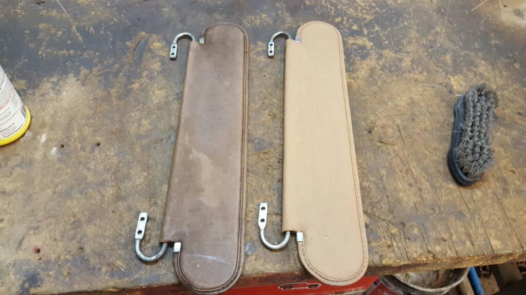

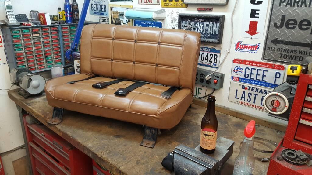

I have some Levi blue visors that need to be cleaned like that, also my blue seat needs to be cleaned, anyway you would divulge your technique
We use purple power full strength in a spray bottle and various degrees of scrubbing. Toothbrush over the threads tho on a seat if you use anything stiffer sometimes you will destroy the near 40 year old stitching... For stiffer scrubbing I use one of those golf shoe cleaner brushes that have metal on one side and soft bristles on the other side, Those work well to get in the creases. This girl I know cleans most of my seats while I turn wrenches ... Although in a less busy life I used to do it myself...
Pretty much was JerseyJeeps said... I use a stiff plastic scrub brush and some smaller ones for the nooks/crannies... some greased lightining, orange cleaner, green stuff, purple stuff, whatever it is at full strength.
A lot of scrubbing.

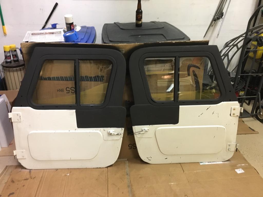

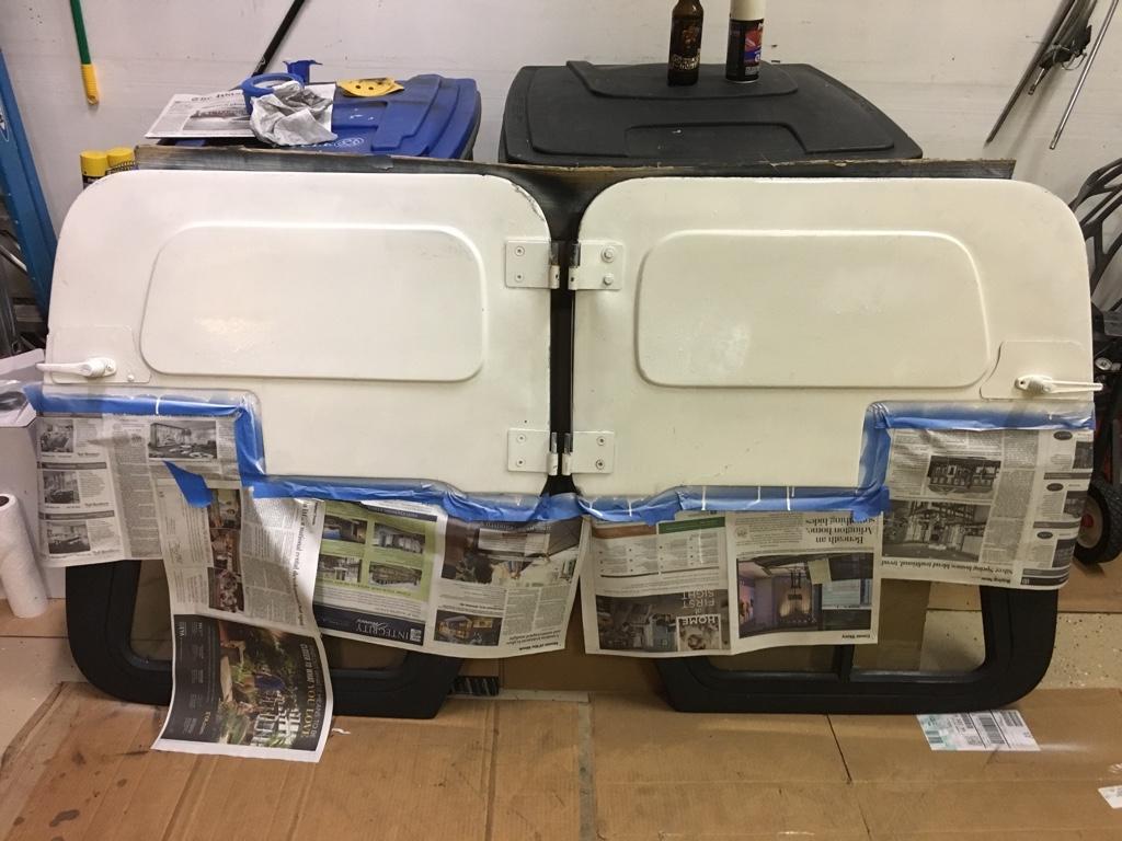

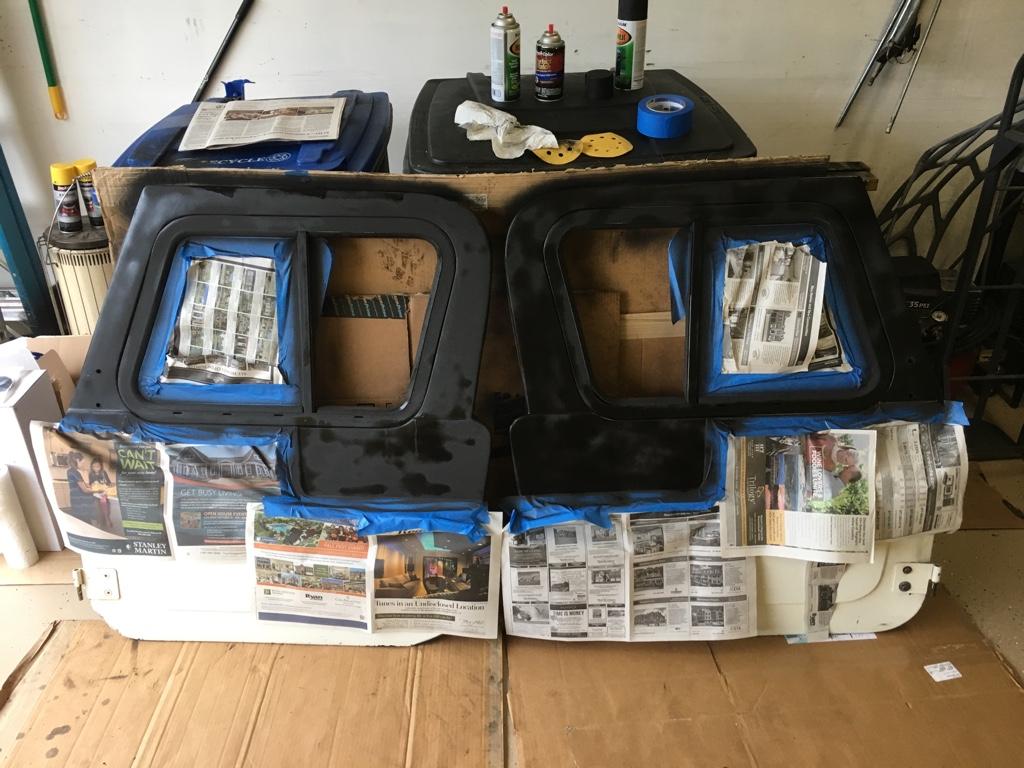

Since I use my trash and recycle bins as a garage workbench until I build one, i think this counts. Painting my full fiberglass doors.
Now to touch up the white
