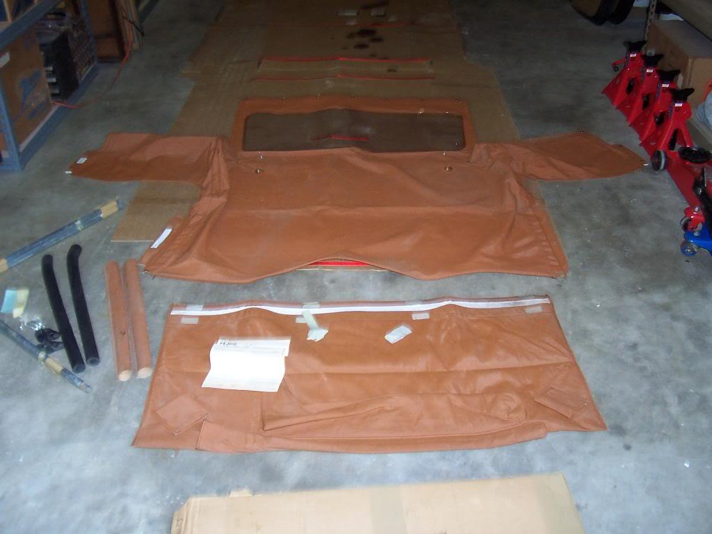

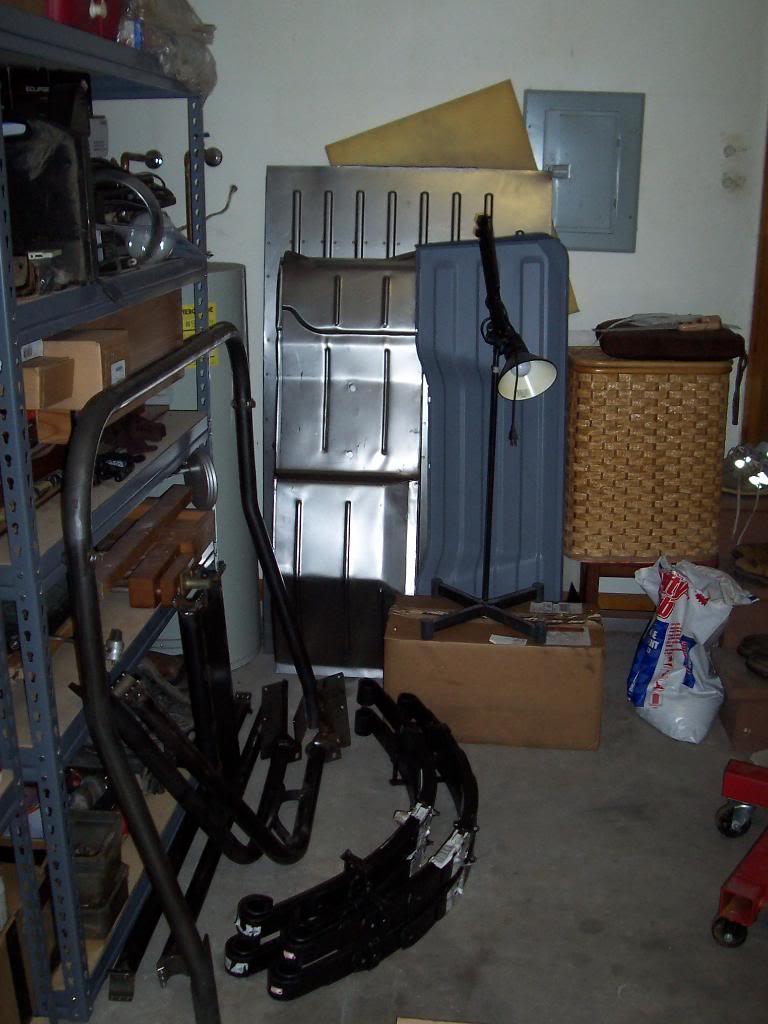

No real progress on my build yet (been busy working on other peoples jeeps:crazy:) BUT I have been busy buying more parts:thumbsup: Here are some pics of parts:D
Floor Pans, Roll Cage, Lift
NOS Whitco 1/2 Soft Top

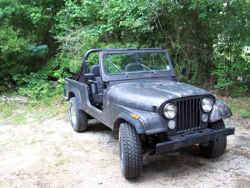

Quick pic of the scrambler while it is still in one piece:rolleyes:

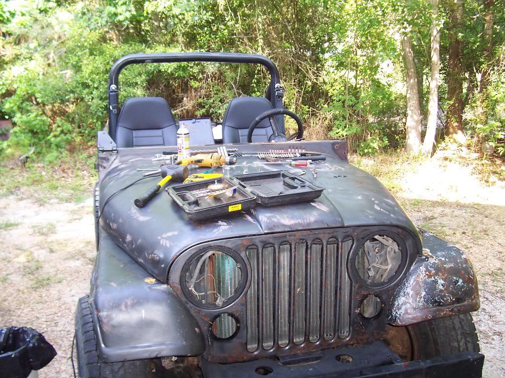

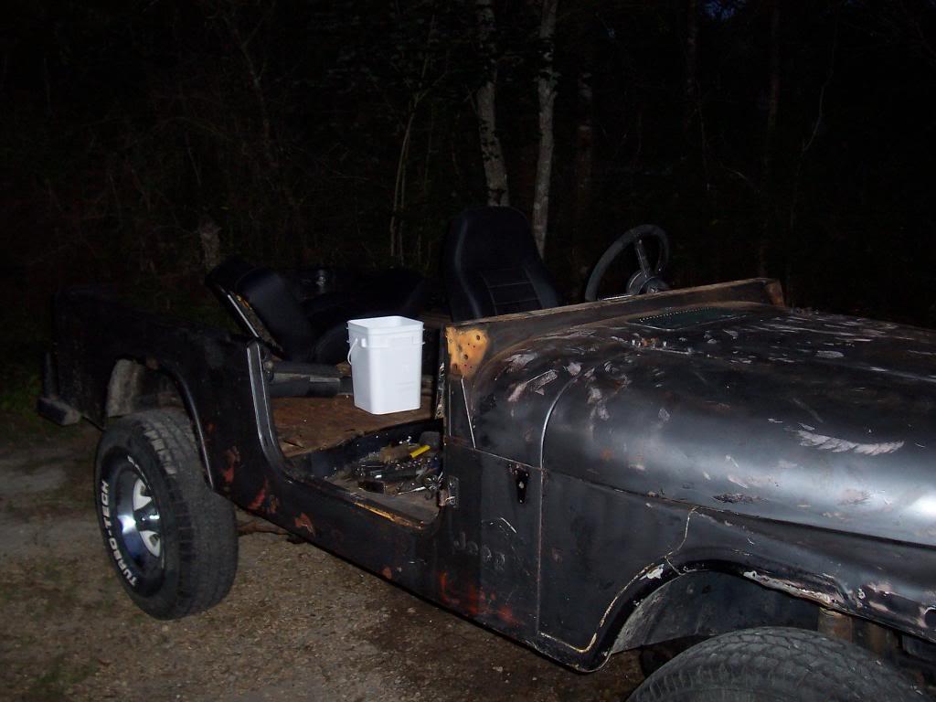

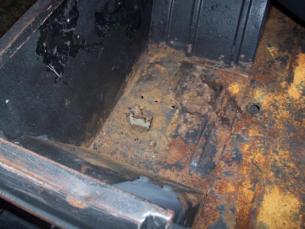

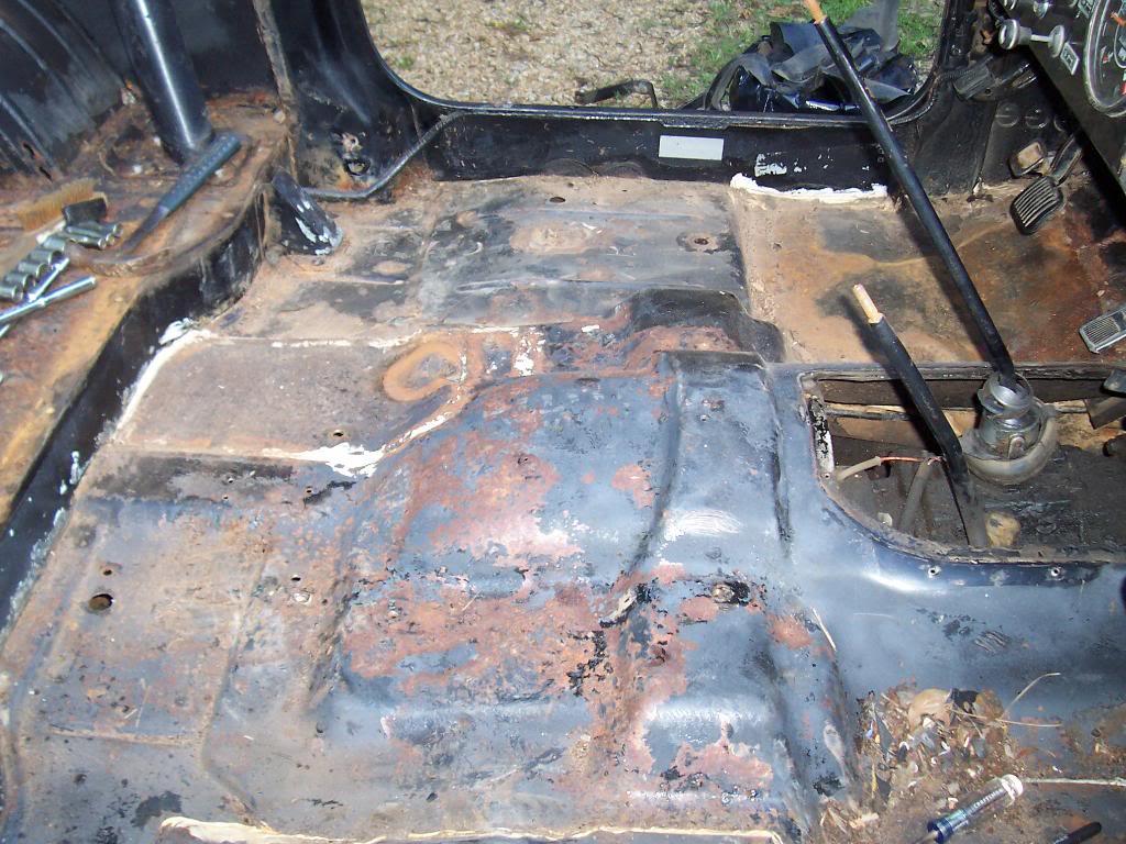

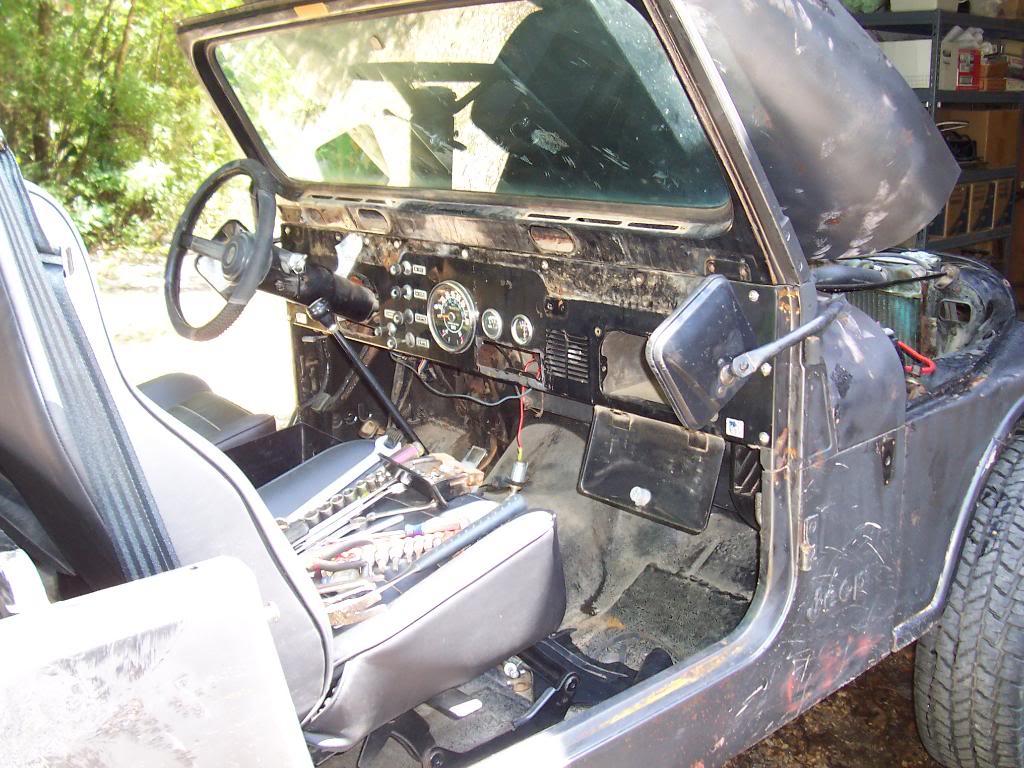

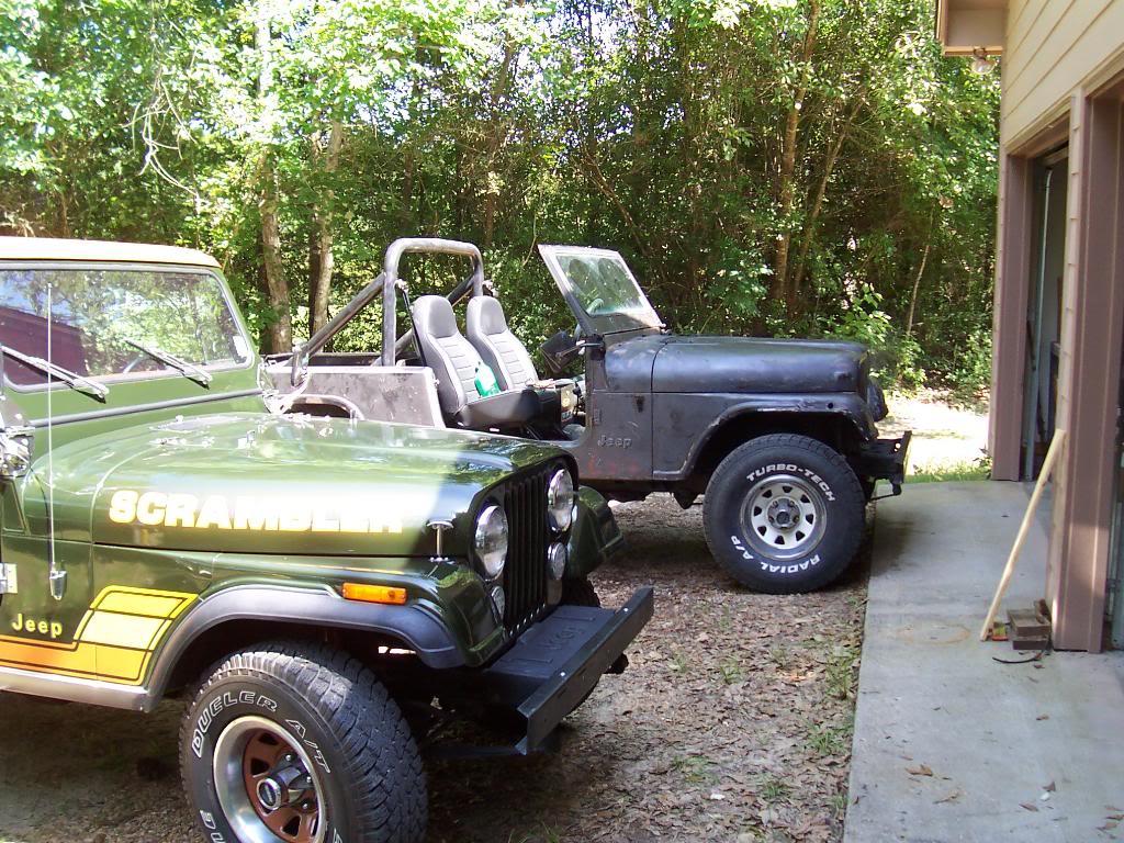

I got bored this weekend and started taking the Scrambler apart
A quick pic of my two Scramblers
More disassembly
Check out the structural sheet metal repair
Maybe thats why the shifter had a little slop

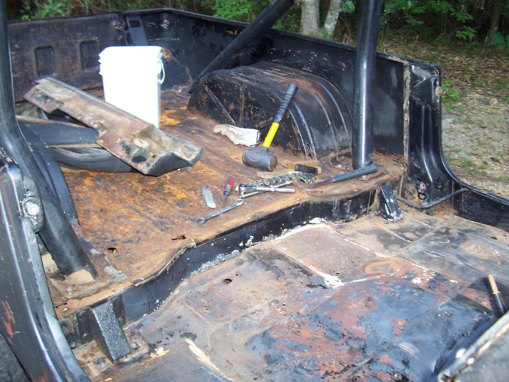

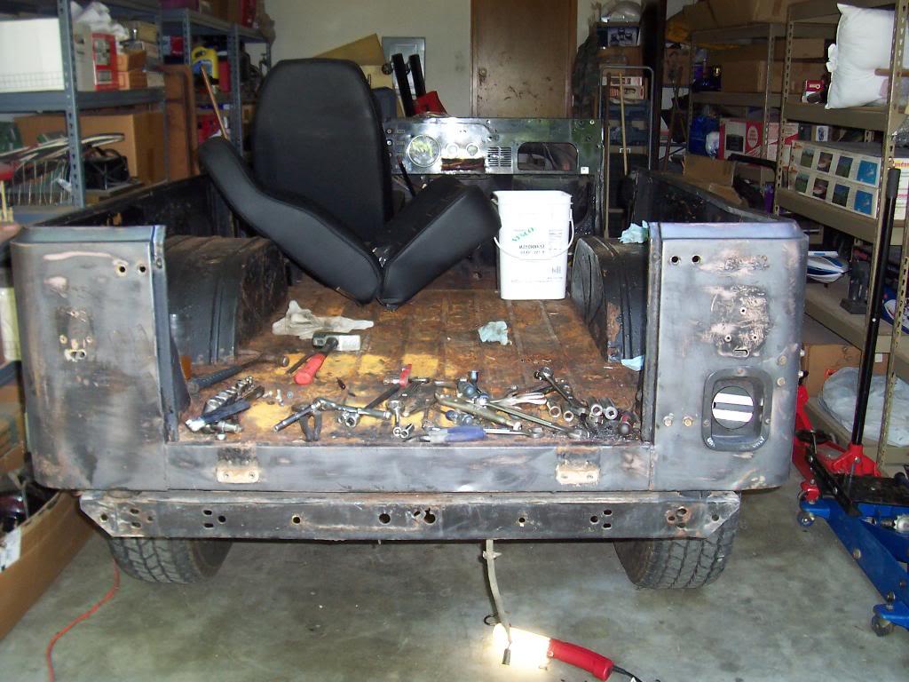

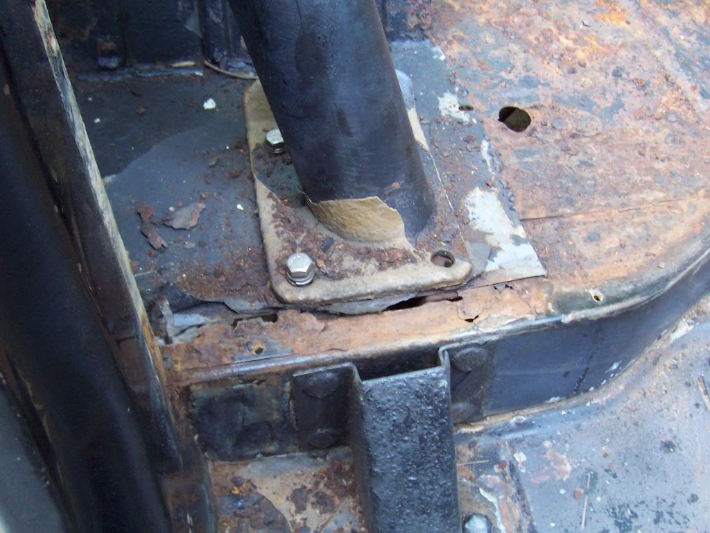

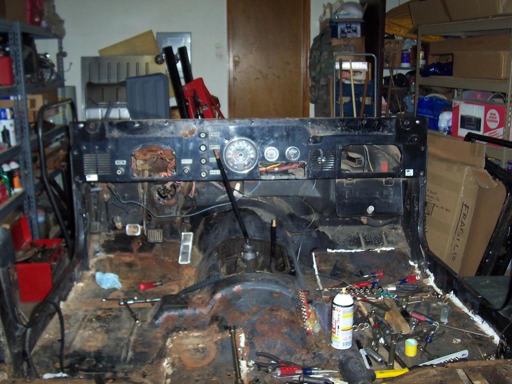

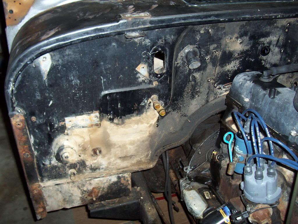

More random pics
Only surprise I found, under rollbar, already ordered the panel
More pics:thumbs

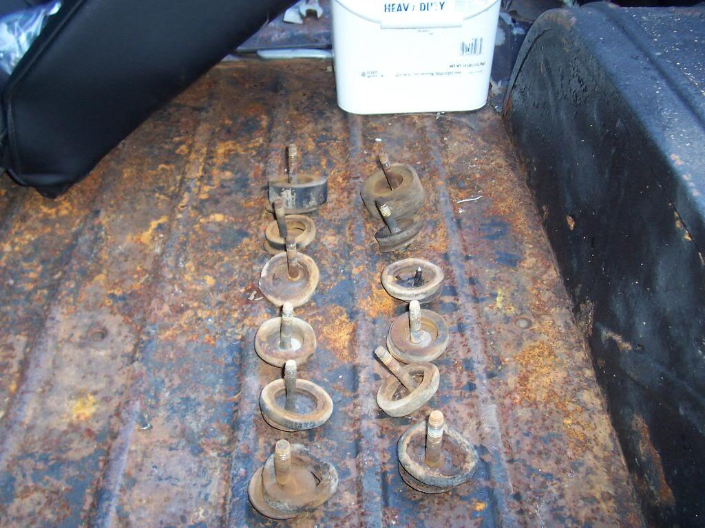

This is my favorite pic, the one thing I was really worried about:thumbsup:
That is a pic of the body mount bolts. If you have ever worked on an old, kinda rusty CJ, you know what I am talking about:thumbsup: If these things break off inside the captured nuts, you are in for a good time:banghead: I was very fortunate, 9 out of 10 came out no problems. The one that broke is no big deal since the captured nut for this one is accessible through an open ended floor reinforcement channel:D:D:D

Great luck on the body mounts! Those don't look like stock bushings on the front ones, maybe someone had replaced them all once already?
Love the deconstruction!!! :thumbsup:
Very Lucky on the body mounts:thumbsup: Yep, those front two body mounts look alot different then rest:eek:

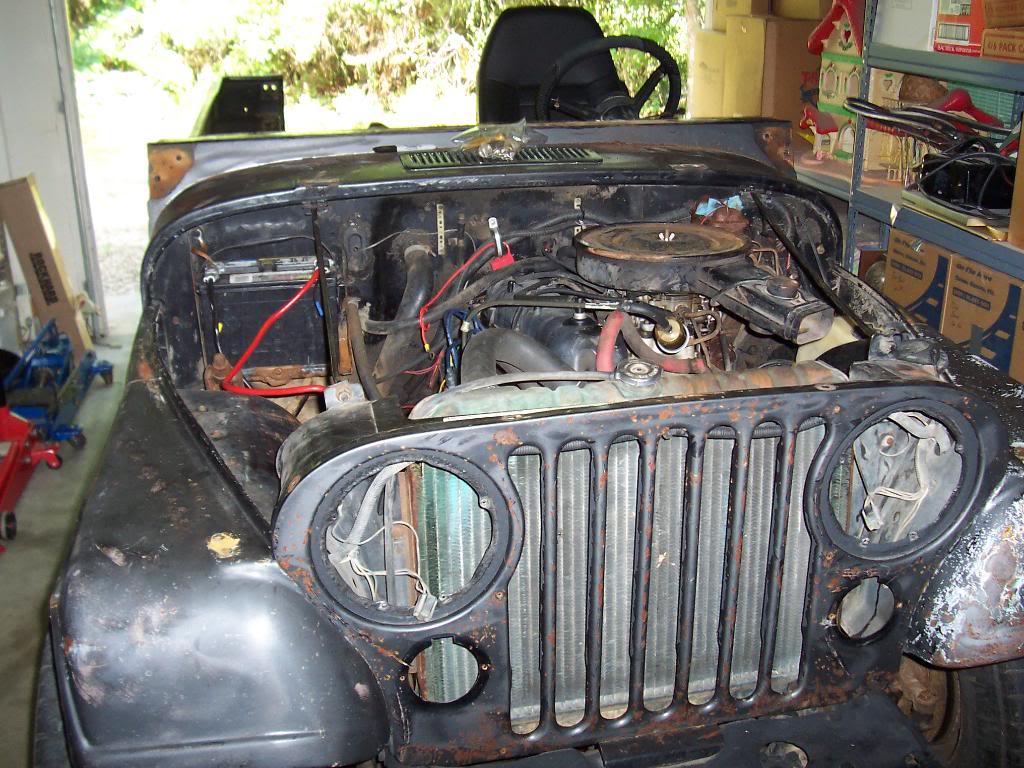

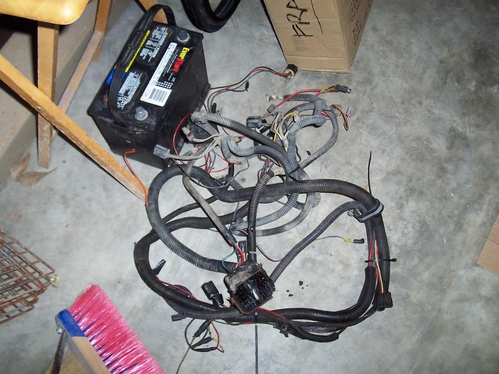

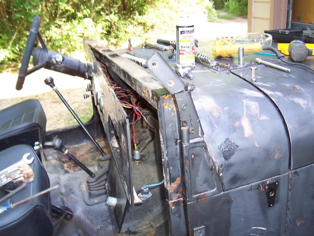

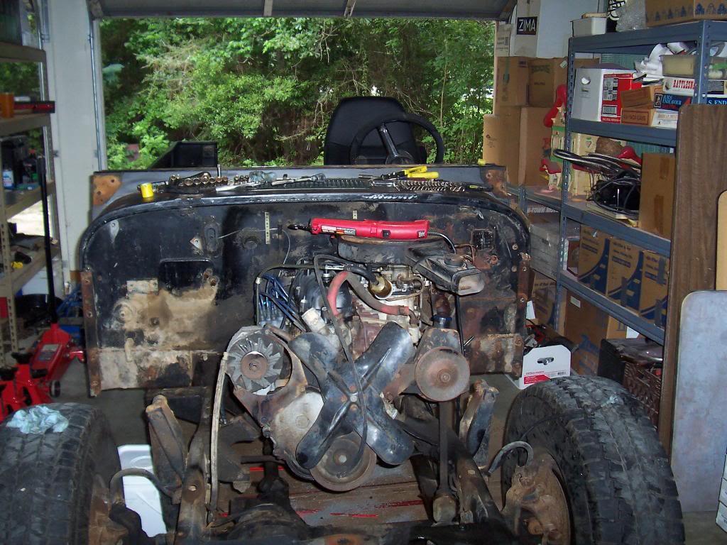

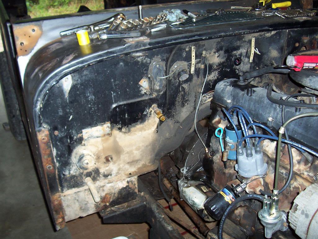

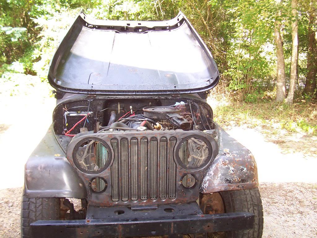

Did a little more last night, but forgot the camera, so I will take some pics tonight:banghead:
Anyway, pulled the radiator / grill, disconnected power steering, removed battery tray, took off master cylinder, and removed the front wire harness (disconnected the front main harness from fuse panel at the firewall).
Later:wave:
Heres the pics

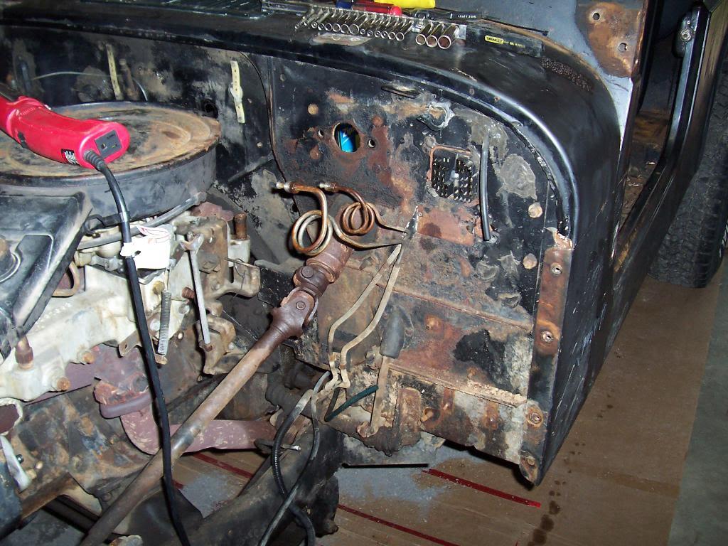

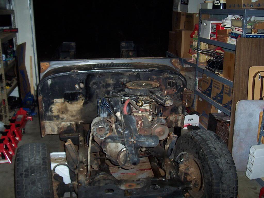

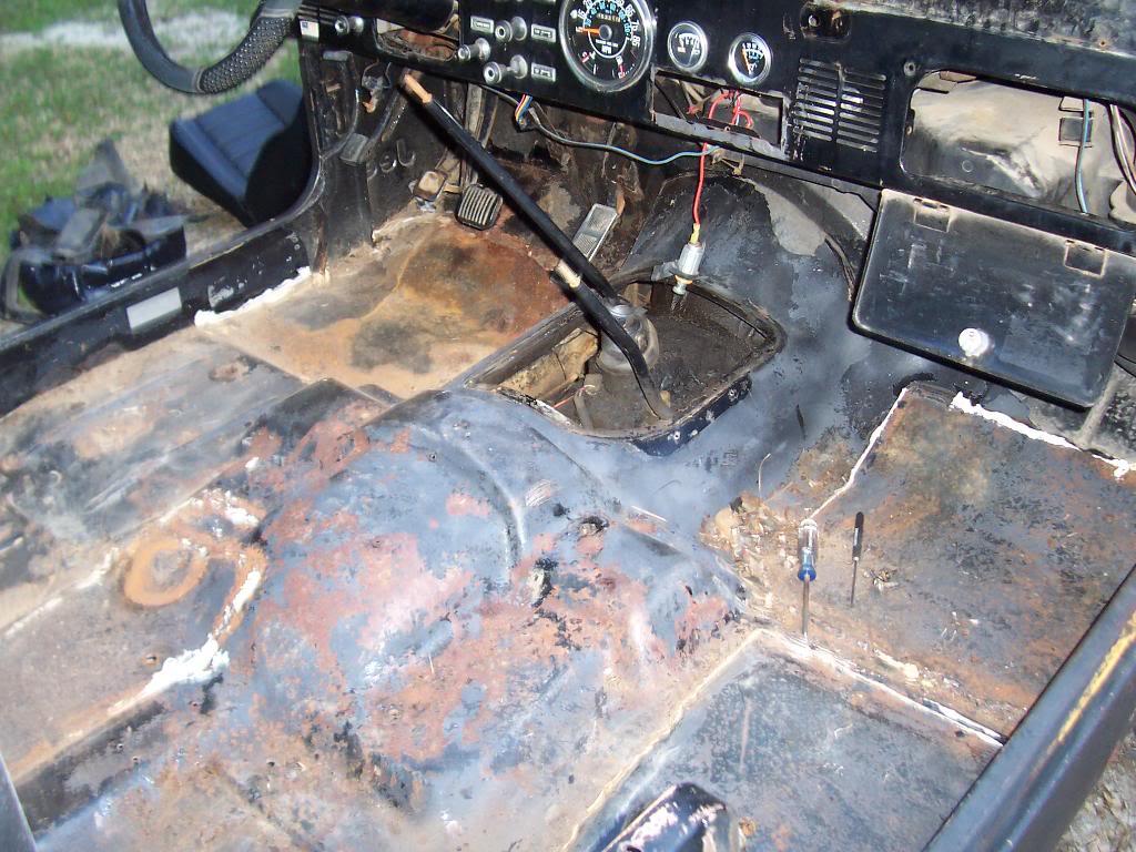

And some more deconstruction, removed steering shaft, pulled steering column, finished taking everything off the engins side of firewall:thumbsup:
Still need to remove all 4 pedals and pull dash plus a few things from the back of the tub, but I should be able to pull tub off this weekend:thumbsup:
