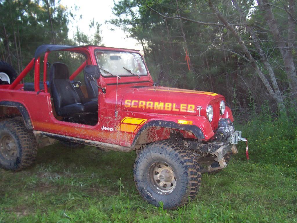

A quick picture just to prove that yes, this thing does get dirty.
