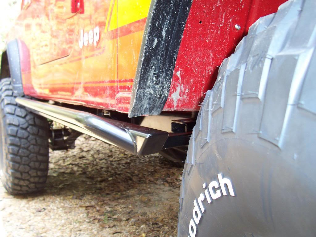

Those rock rails look great! Have you decided which way you are going with tires/wheels?
Appreciate it. I am very happy with how the rails look, I hope they function as well as they look. I will try them out at Moab in report back
