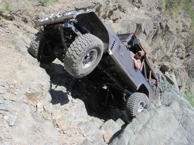

I had a chance to get it out and do some testing today. I've been slacking on updates because I just haven't been taking the time for pics because I'm so far behind. Everything today worked out perfectly. So now that the drivetrain side of things are squared away, it's time to have a little sigh of relief. I'm almost ready for Moab......
Here's the first pic of the couple that I'll post later on.....
All I have to do now is order a smaller diameter power steering pulley so I can have more assist at idle and low RPM.
