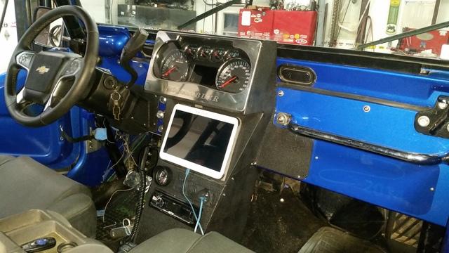

I made a panel below where my tablet is mounted for the AM/FM, glow shift air pressure, 12V outlet, constant power USB, and Keyed power USB.
The air bag hole in the steering wheel got a temporary cover till I figure out what I want to do, It wouldn't have been bad, but the glue oozed out from behind the Chevy emblem and dried before I saw it. :banghead:

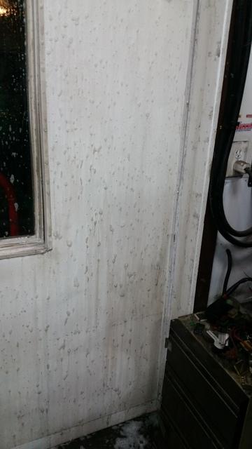

Washing the door

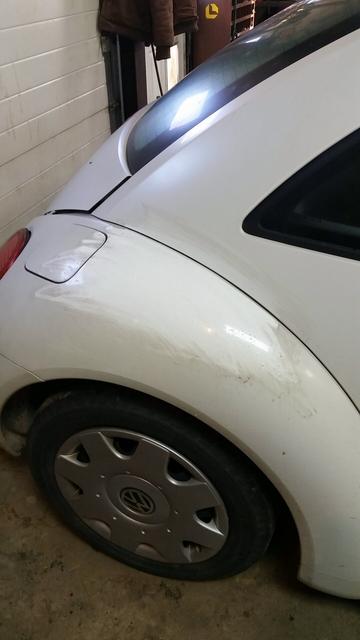

The VW fender
