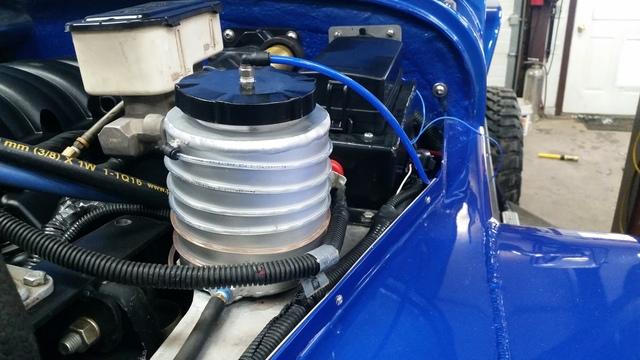

Coolant overflow is done. I had to take the spiral site glass off and replace it with a regular one. There was too much surface tension in the plastic tube and it wouldn't flow the coolant.

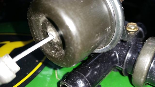

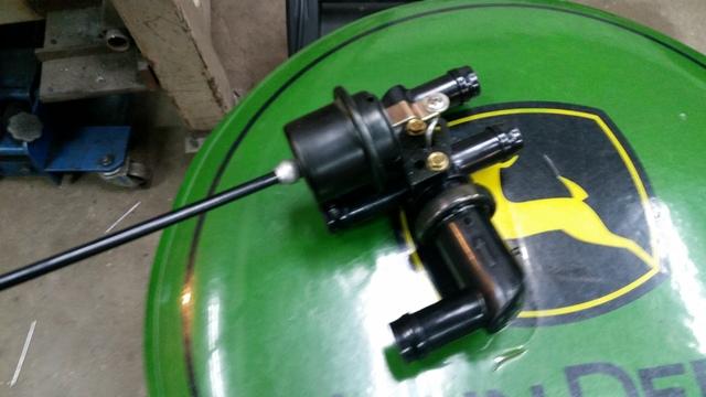

This next mod isn't really needed yet this time of year. Looking ahead to this summer I'm looking for ways to keep the inside cooler, since my AC isn't installed at this point. One place of heat generated is the heater core. With the newer motors you can't just "shut off" the coolant to heater core. It is a bypass. So I went on the interwebs searching for a bypass valve. They're out there...............for a not so small nominal fee. Then I found this vacuum valve off a Ford Ranger........for $12 on ebay.

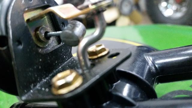

Since I don't have vacuum controls. I'm converting it to cable. I had a bicycle cable laying on the shelf. Next step was to cut off the hose nipple and drill that hole out to the cable size. Then I drill through the diaphragm and the actuator arm. That gave me a place to route the pull cable.
The plan is to run the cable inside and attach the end to the temperature arm with a spring. That way when I push the temp all the way in it will close the bypass and no 200 degree coolant flowing into the cab...........to be continued after spring break
