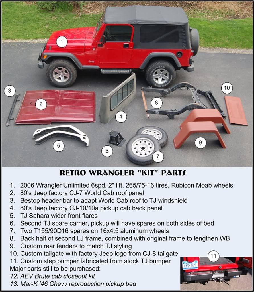

Retro Wrangler Kit (apologies to Eric)
Eric always chastises me when I use the "K" word, but I was cleaning all the winter road grit out of the garage today, piling stuff up in the driveway, and it seemed like a good photo-op. :)
Not shown are a bunch of boxes of smaller parts like the custom tailgate latch mechanism, frame fish plates, tailgate brackets, pickup bed support brackets, etc. etc. that I've either fabricated, eBayed or found at the Pick-n-Pull.
I think I've pretty much reached the end of the line on stuff I can fabricate before I cut the LJ in half, now just waiting on the new house to be finished so I can gather up my bravery and cut into the LJ... :eek:
Jeff
Cool picture of the "Kit". :D
As far as the bed, for looks I like the woodgrained side, but for practicality the plain side might be better. Question- since the decking material was designed to be installed "pretty" side up, does that side have better or deeper pigmentation?
Maybe try laying the wood and metal out like they'd be in the bed, and see which one looks better. I'm guessing then plain side might look too "fake".

All four sides seem to have the same depth of finish. I think we'll have to wait until its built and see how it looks with both sides; right now I'm leaning towards the plain side but maybe the grain side will look better when it is in the truck.
I ain't saying nothing... that's just a sweet photo right there!
