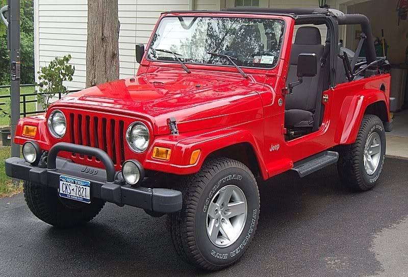

Since I'm going to use painted front flares on the pickup to better harmonize with the rear fenders, I picked up a used set of wider painted Sahara flares a while back on eBay. They were painted white, so I'm in the process of painting them Flame Red now. I experimented on the rears first, since they're not part of the end result of the build, and they turned out well enough that I'm now doing the fronts. Below you can see the rears pretty much finished (when the paint has hardened about a week I'll probably buff them to perfect the shine), and some of the front parts on the bench in primer and first coat of color. It's a bit hard to get a factory finish with rattle can paint, but I think I've got it worked out.
Should be done with them by mid-week and will install them on the LJ. Just one more task I can tick off while waiting for the house to be done.

Finished painting the flares to match the LJ. Now I have to wash and wax the LJ before I put these on or they'll make the LJ look bad :).
Probably will install them Thursday, I'll give the paint a chance to harden up some more before I handle them too much.
Not sure I'll like the painted look better than the black look, but painted flares on the front will be necessary to integrate with the painted pickup fenders on the rear.

I didn't know if I'd like them but now that they're done I gotta say I actually like them better than the black ones that I could never keep clean or black. Finish came out as good as the factory finish on the LJ, not bad for rattle cans. I did have to wash and wax the LJ so it looked as good as the freshly painted flares. :)
I think these will go just fine with the painted rear pickup fenders, definitely will go better than the black ones.
Probably no real work will happen on the pickup project now until the bed arrives, that's still two weeks away.
That looks great, jscherb. I like it better than the stock ones, too.
