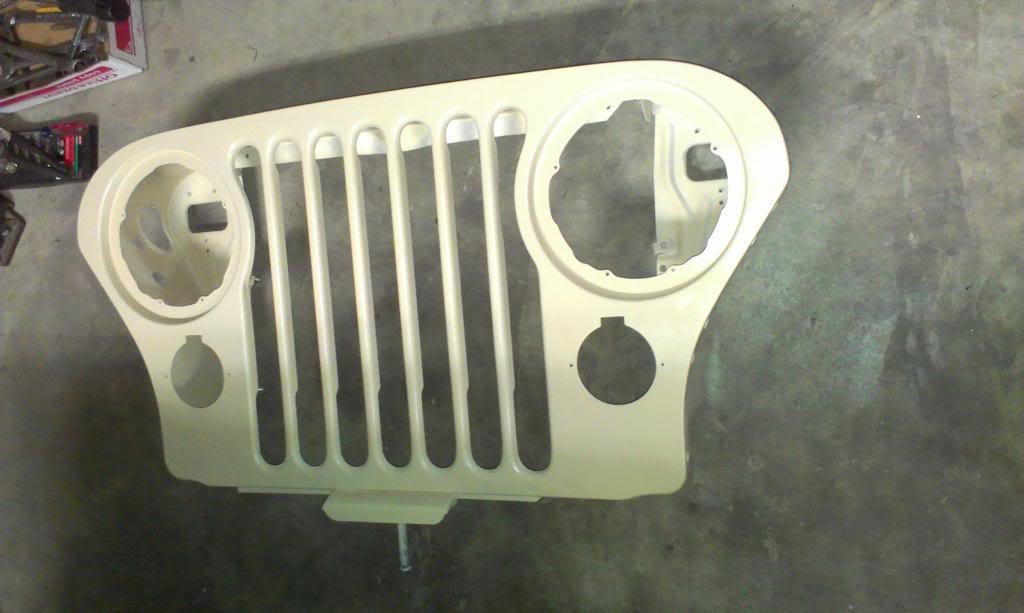

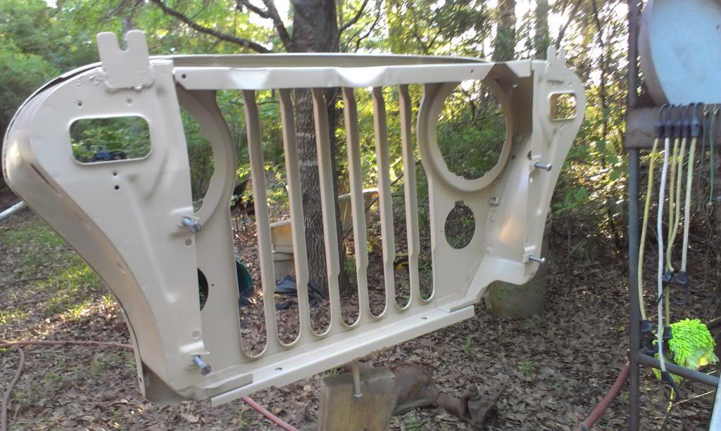

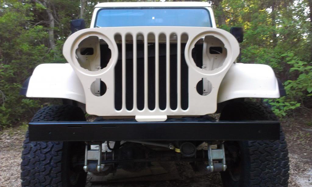

One more "paint the grill update".
I was able to spray some clear over the grill late yesterday. I used one can of clear, and was able to get about 5 light coats on it.
And again, the side facing the sun looks more brown.
But the back side, away from the sun, looks like the correct color.

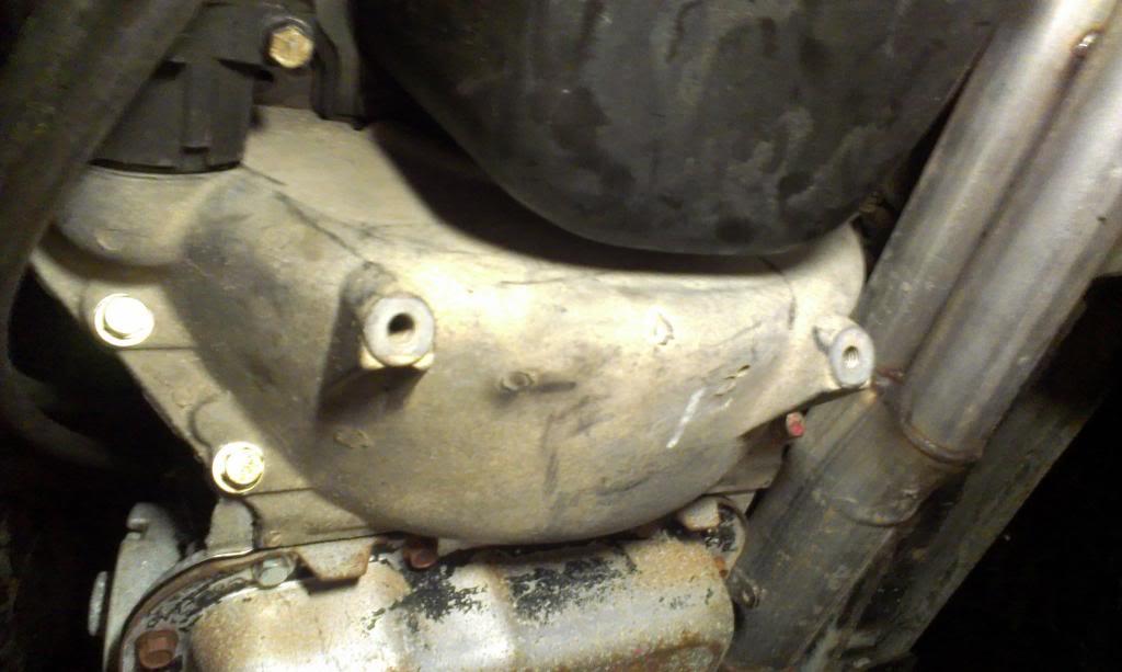

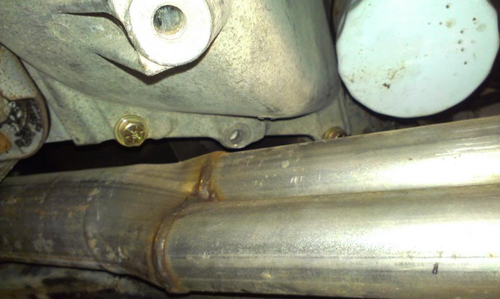

I finally bolted on the torque converter inspection cover. I was able to get 5 of the 6 bolts in, the exhaust is preventing me from installing one of the bolts, but it is not going anywhere.

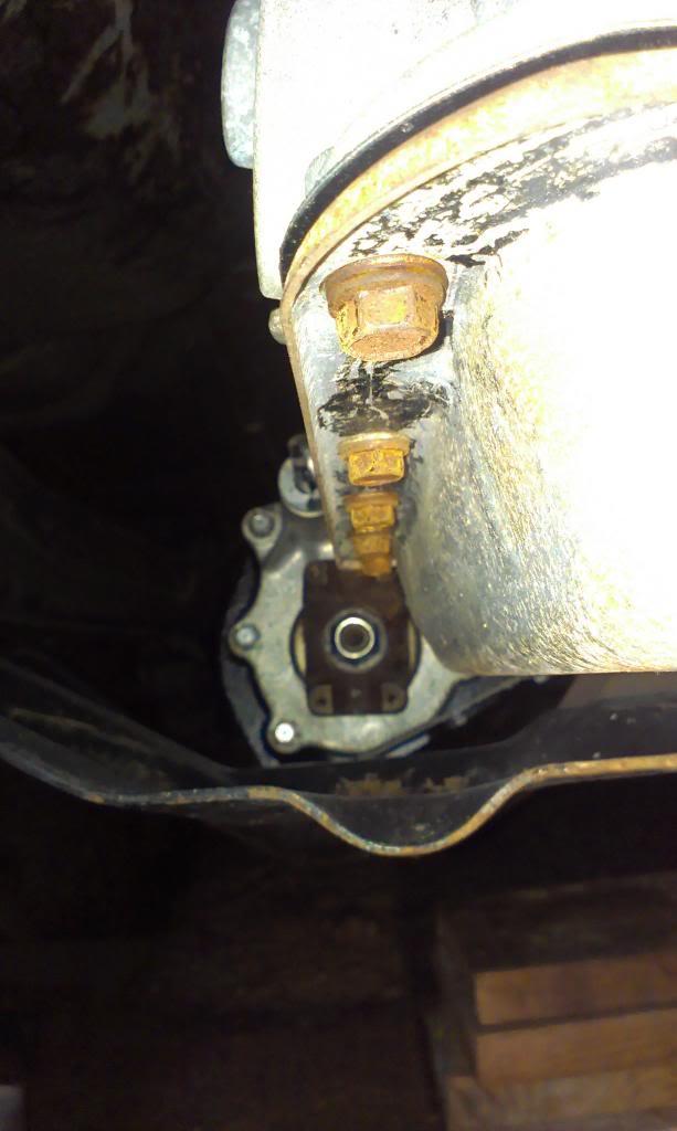

And since I was laying on the ground down there, quick picture showing the front drive shaft clearance concerns. It is tight, but it should clear (FINGERS CROSSED). I am currently having a front drive shaft made, and I am also having the rear drive shaft shortened, due to the increased length of the Advance Adapter's HD Dana 300 rear output. The new output is 1" longer, and the existing drive shaft was a hair too long, i.e. on compression it would have bottomed out hard.
After a couple of hours, the grill looks the correct color again. It could also be the bright, overhead lighting, too.

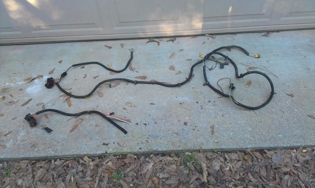

I also removed my "cut in 1/2" front light harness, so I can install my recently acquired "not cut in 1/2" front light harness. Full one at top, half one at bottom. I could have fixed the old one, but it would have been pretty butch. I think this is a cleaner/simpler/easier fix.

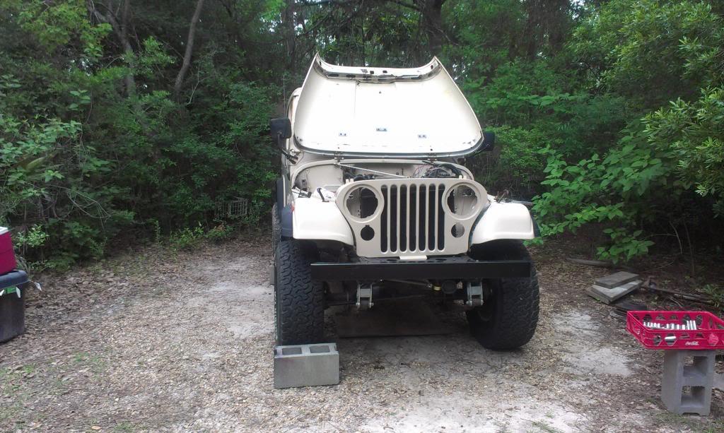

Two quick pictures from this morning, I really believe the grill matches pretty darn good now.
I am going to wait a few days, then buff/install the front grill and all of the lights. I also need to spend some time adjusting the hood/fenders. They were quickly bolted back on by the previous owner, and they need a little adjusting/finish installing/bolting down.

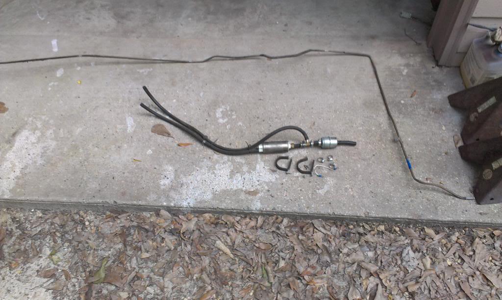

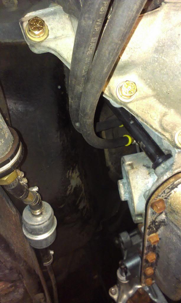

Switching gears from painting to plumbing.
I was not too happy with the current fuel supply/return set up. The fuel pump was mounted near the front spring hanger, the return line was "t'd" into the supply line right in front of the electric pump, generally, just didn't like it.
My new plan:
Mount pump on rear cross member (the one that holds up the front of the fuel tank)
Run new supply/return lines down the passenger side frame rail (on this engine, the supply/return pickups are both on passenger side, right in front of the motor mount)

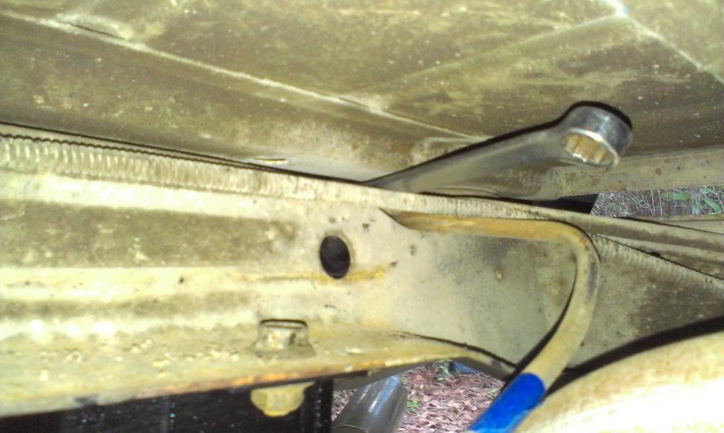

First up, taking off the old fuel supply line. The blue tape shows where I plan on cutting the line. I am going to reuse a short piece of the original line, from the tank to the cross member. The 3 lines that pass over the cross member and go to the back, are secured by a hidden clamp. There is a bolt that holds the clamp down, in the below picture the wrench is on it. It is very much fun to loosen/tighten!!!

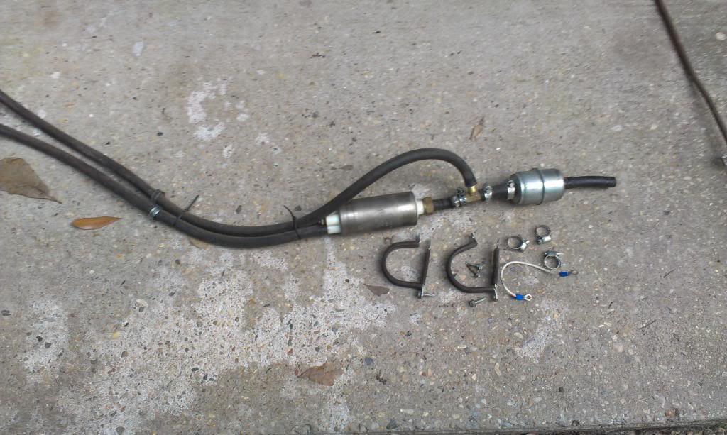

Quick picture of the old plumbing removed. Note the "T'd" in return line.
And the easy part cutting, the old line and flaring the end. This short piece of line will tie into the rubber supply line on top of the gas tank, then pass over the cross member, then turn 90 degrees toward the passenger frame rail. I will tie my filter/pump at this point.

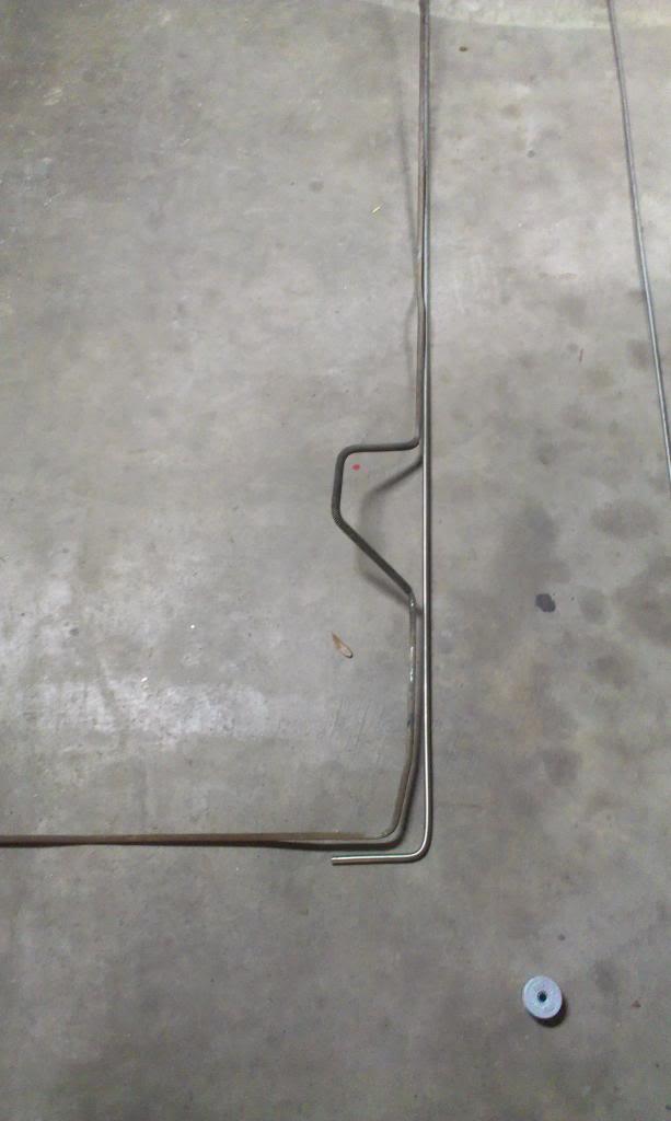

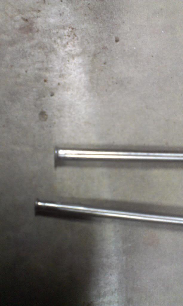

Quick picture of my new lines next to the original. In a "lack of planning moment", I only bought 8' long pieces of tubing. This will work, and the hard lines will end right at the front spring hangers. In hind sight, I wish I would have bought 10' long pieces of tubing, this would have brought the hard line almost to the engine mount, and would only require approximately 6" pieces of rubber line. With my 8' pieces, I am going to have to run 18" long pieces of rubber line. Not the end of the world, but hind sight is always 20/20. The tubing I purchased is .035, stainless. I bought it from a local hydraulic/pneumatic repair shop.
The factory supply line has the weird "bump out, go around, then go back to the frame" bend. This is to clear the old style, full bodied shocks. Since I am running newer shocks, with only the "shiney rod" passing next to the frame, I do not need to make this weird "clearance bend".

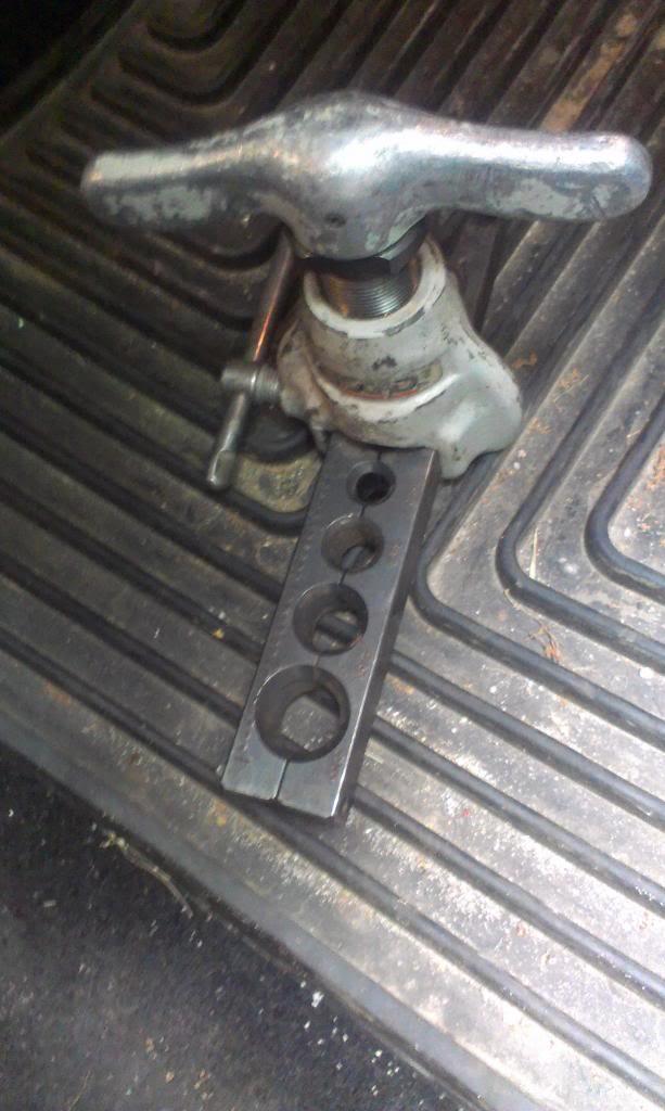

And the most frustrating part, making "flared/bump out ridges" on the ends of the metal line to help secure the rubber lines. I should have learned my lessen with this when I was messing around with my lines from In Line Tube on the red Scrambler - typical POS flare tools will not touch SS tubing, easily!!!!
After about 4 hours of frustration/cursing, I was able to make some "flares" on the ends of the lines. In hindsight, I should have let the hydraulic shop do this. Not the pretties job, but it will work.

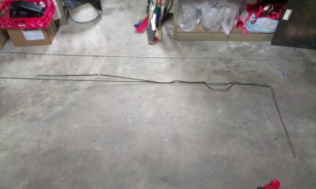

A little bit more work complete.

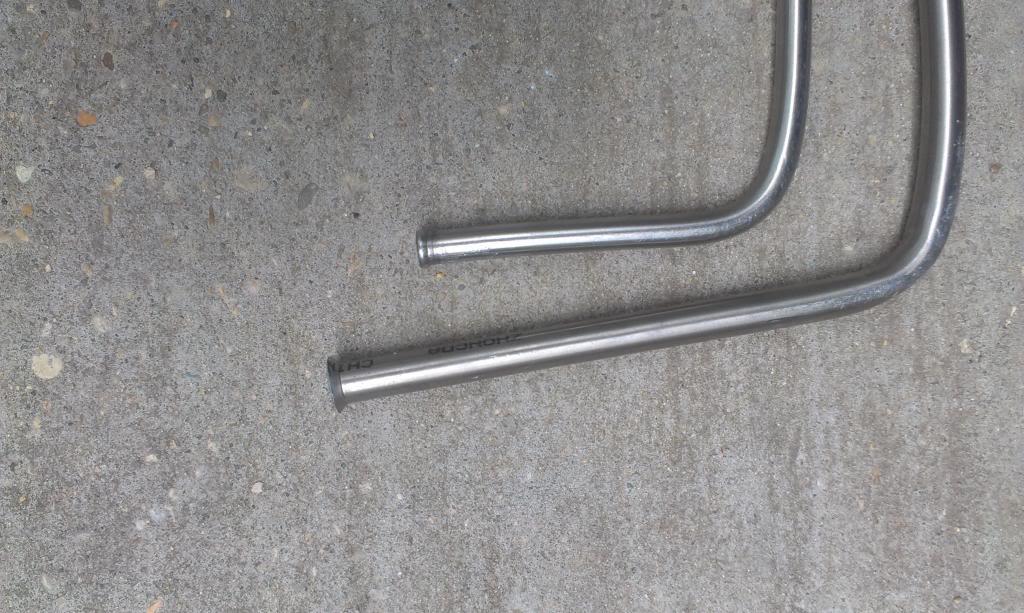

I borrowed a different flaring tool, and had a little bit better luck flaring the ends of the stainless lines.
And a picture of my new "supply/return" lines, pretty long, wish they were a hair longer, but they should work.

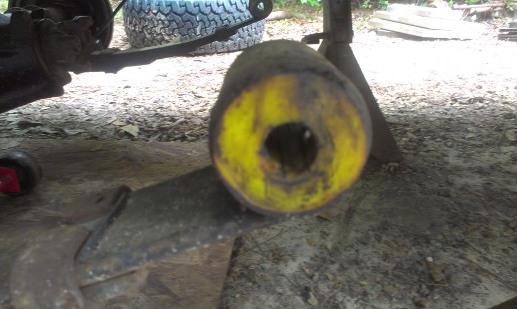

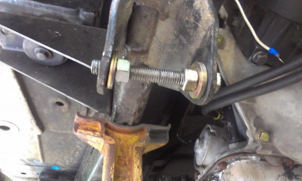

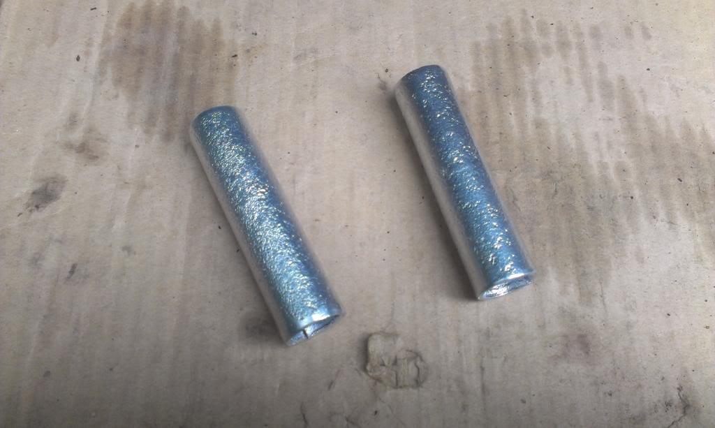

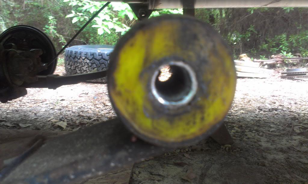

I also did some more suspension work. I had previously discovered, when trying to torque one of the main eye bolts, what I thought was a missing internal sleeve. Turns out I was right, all four main eyes had no sleeves.
Quick picture of my "bling-bling" replacement sleeves.
The sleeves installed. They tapped in very easily.

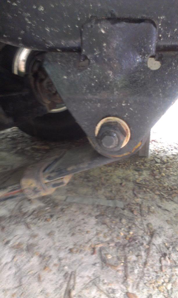

On the one spring eye hanger that I previously tried to toque, I had to use my "redneck spreader tool" to open back up the hanger slightly. Since I had not previously tried to torque the other 3 main eye bolts, those hangers were fine, the bushings/spring slid right back in.
And all bolted back together/torqued. This was a bunch of work for four bolts!!!

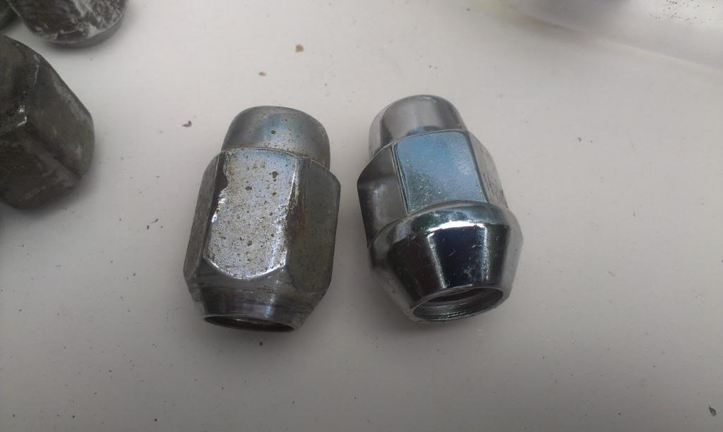

And since I had the tires off, I also replaced all of the incorrect lug nuts with the correct type. The correct type is on the right, the nut on the left is for the stock steel wheels.

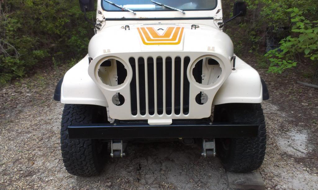

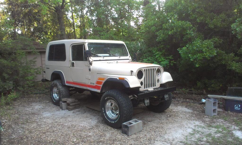

I also started to bolt the grill back on. I still need to adjust the front fenders/hood, but its a start. I think the paint matches pretty good, not perfect, but good enough. Once I install the headlights/turn signals, the slight shade difference might be less noticeable.

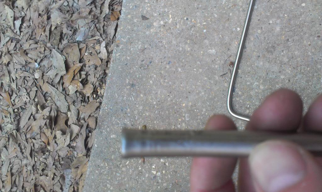

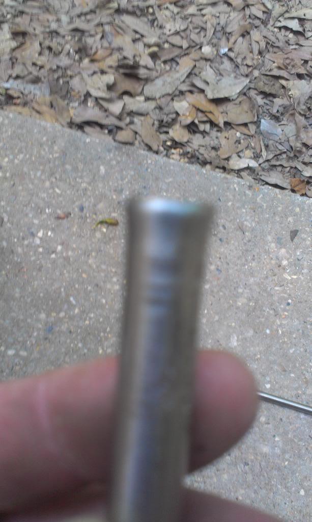

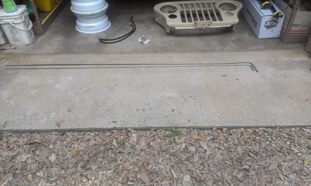

NOTE - the flare on my 3/8 line is incorrect - it is too sharp, it will cut the line. I am going to go back and redo it. All that is needed is a little "bubble flare", like the smaller line has:thumbsup:
I went back and re-flared the tubing, much better results. The pictures do not show it too clearly, but I now have a nice, round, 1/2 bubble on all the ends. This will prevent the rubber lines from coming off, and will not cut them. My previous flares on the 3/8 tubing were too sharp/abrupt.
And, more importantly, I test fit my new front drive shaft, and it fits just fine. I was really worried about this, 700R4's and stock width axles can sometimes cause major front drive shaft clearance issues. But, whoever installed the engine mounts did a great job. My engine is offset to the driver side by at least 2". The driver side exhaust manifold is about 1" from the steering shaft. As a result, using a stock OD front drive shaft, I still have about 1/2" clearance between the side of the transmission pan and the drive shaft. And, I have plenty of clearance between the top of the drive shaft and the bottom of the pan-case mounting flange.
