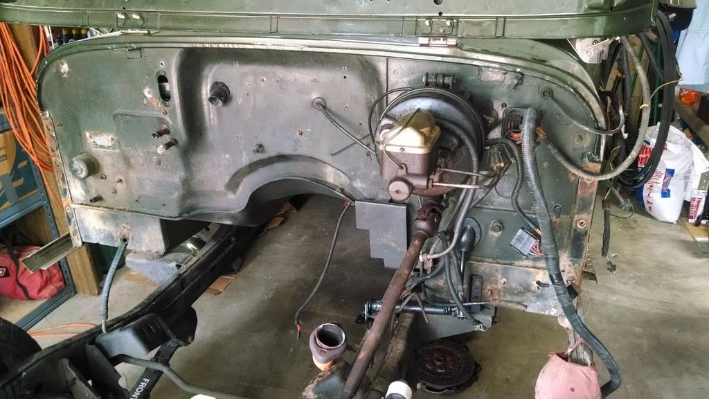

Well, my OCD/anal retentiveness got the better of me this weekend. As if I didn't already have enough parts to clean up already, I went and pulled the passenger side fender off, too. This Scrambler was repainted the factory color a long while back, but the under hood area is still the original paint. It is no where near as shiny as the exterior paint. This bugged me. Can't put a new engine/transmission/transfer case back in a dreary engine bay. So.................
This picture is before I washed the firewall:

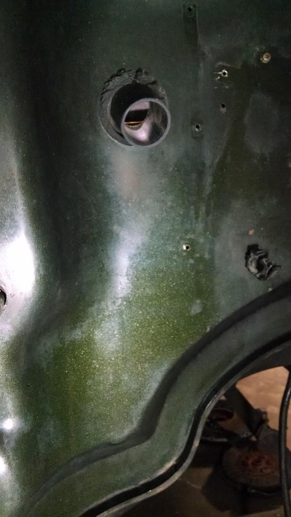

I cleaned the firewall, first with Simple Green, then Dawn dish washing soap, and finally car washing soap. This was a PIA cleaning fire wall in the garage. I used buckets of water, rags, and a lot of time. I would clean a small area, then use a squeegy to get the water out of the garage. Wish I had a concrete driveway!!!!!!! Anyway, it still looked blah, lots of dead/faded paint. I started to polish a small area by hand, it looked much better. In the picture below, you can see the polished part toward the bottom left. Note all the dead paint splotchy areas above and around the polished area:

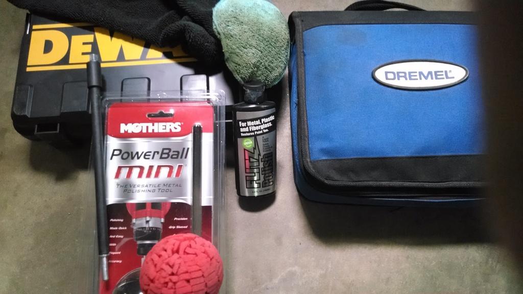

Well, that looks much better. But, it would take forever to do the whole fire wall by hand. So, I used some tools I already owned, Dremel and a Drill, and went out and bought two things: (1) The Mothers Mini Power Ball (2) The Flitz Polish. No real reason I tried this polish, just figured I would try it.
Well, I was very happy with the results. The Mini Power Ball worked awesome, and the polish did, too. I was able to polish probably 95% of the firewall, and it looks much better, and it only took about two hours.

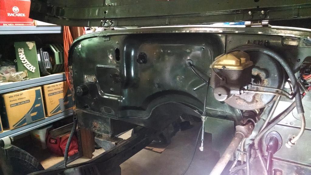

This picture is with the garage door closed, drop light on, and I had not yet polished the fire wall around the steering column/master cylinder/wire harness/clutch stuff:
A better picture, 100% polished, natural light shining through open garage door. The "white haze" you see toward the passenger side is a reflection of my t-shirt!!!!!!!

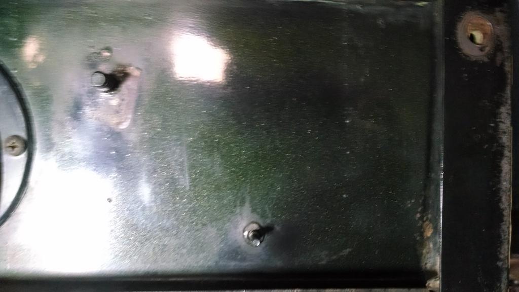

A close up, which shows the sparkle. Also of note are the bare paint areas, showing a black primer. I found this same primer on "Yard Scrambler I", which also was Sherwood green:
All in all, I am very happy with the results. Except, I will now have to polish both inner fenders!!! I know this was probably over kill, since you will never see most of the firewall/fenders once everything is back in, but I am happy with the results.

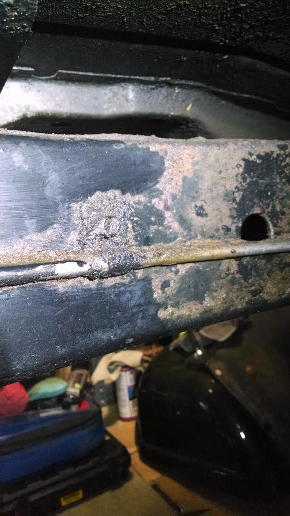

Well, I then turned my attention to the frame. It is not rusty, but dirty, greasy, and dull:
This Scrambler was originally bought for a high school kid, so I knew I could find some evidence of a more "exciting life". Sure enough, looking down into the front shock towers, packed full of Mississippi clay/oil/grime/sand:
So, I removed both front shock towers and the engine frame mounts, to make cleaning easier. Picture of the inside of one front shock tower:
And the frame where the shock tower was sitting:
Don't worry, the orange you see on the frame is NOT rust, just good old Mississippi red clay.
So, now I am going to clean the frame up, and the under body, at least to the rear spring hangers. This should get rid of most of the old leaking oil that coats the under sides of old leaking Jeeps. Anything past the rear spring hangers can be done easier outside, once the Scrambler is running again.
