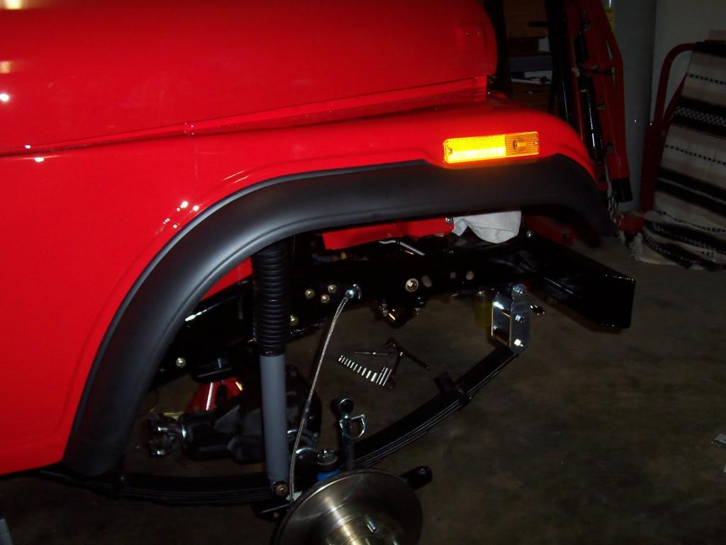

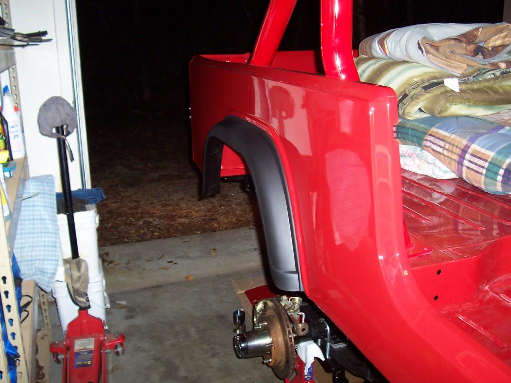

Put on all 4 fender flares. Those rear ones are a pain in the butt, front ones were easy except for the fact that the body guy filled in two of the mounting holes. I already used a drill on this body, no going back now.

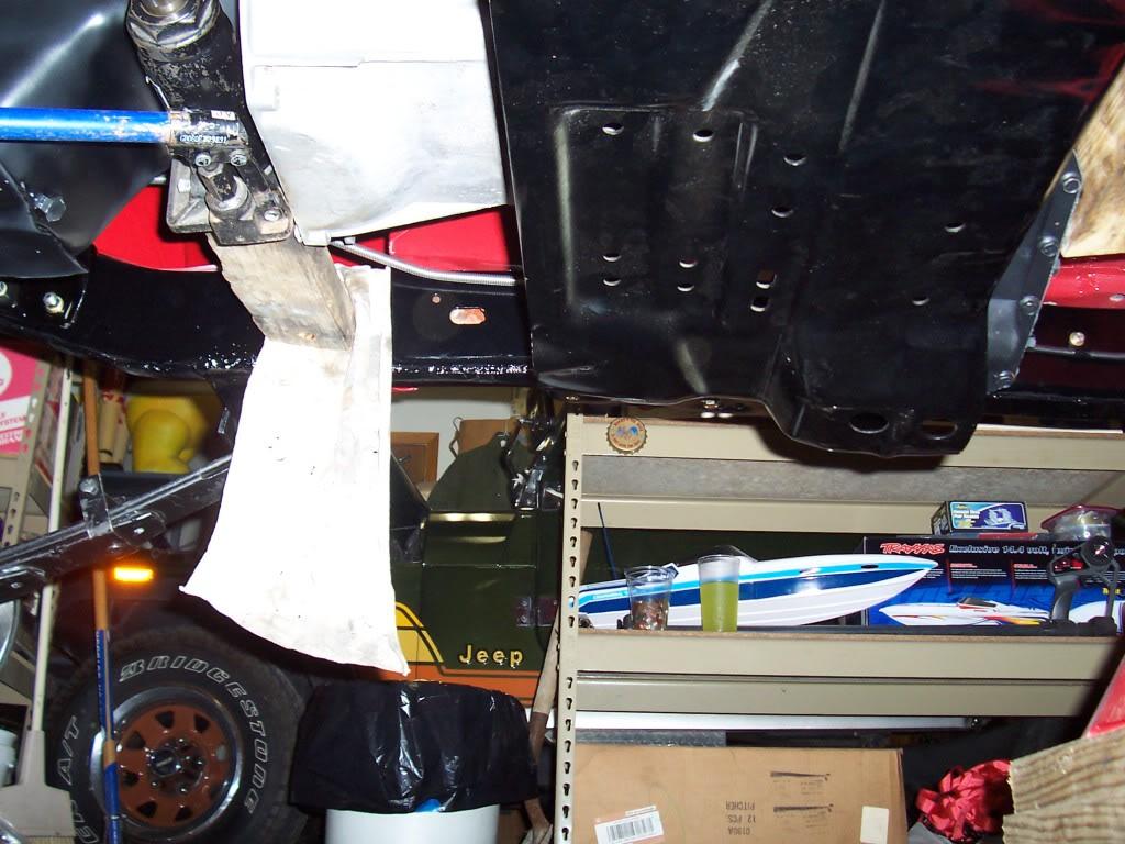

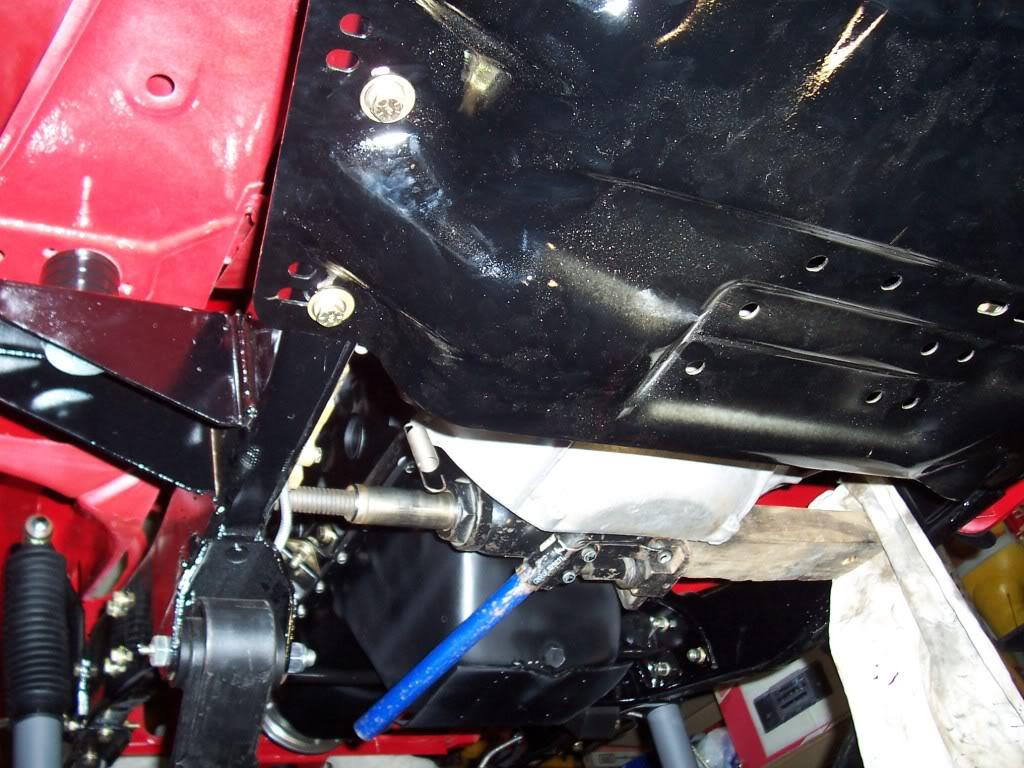

Mounted up the skid plate. I had to use a bottle jack to spread the frame apart to get the skid plate to mount back up. The frame had "narrowed" by about 1/2 an inch. You can see the bottle jack in the picture in front of the bell housing, it has a blue handle sticking out.
I used a ratchet strap to gently pull the transmission/transfer case over about 1/2 inch to get the holes in the mounts and the skid plate to line. It is now finally bolted in place, no more jack stands supporting the power train.
