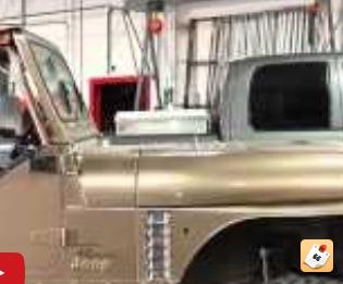

It's time to start making some changes.....
I love that new scope, or is that the top of the blower !?
Sent from my iPhone
Thats no scoop. Thats the tool box in the back of the Dodge!
