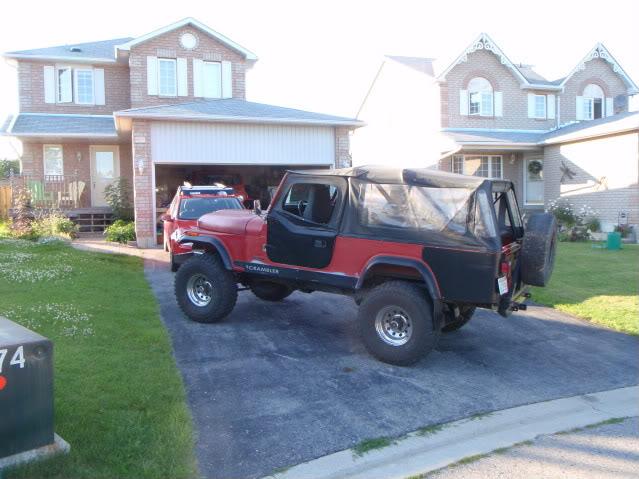

teaser pic... in the driveway, home safe and fully Canadian now!!!
I'll post something more tomorrow... tired.
would i do it again? yup!!! we're a bit wacko...:crazy::crazy:
Sweet looking ride and looking forward to more pix. Glad you and your wife made it home safe and sound.
Tim
Congrats!!! My respect for you just went up a couple of notches as I was not aware that you made this journey with a soft top.:bow: Looks like a very nice, capable rig and a nice addition to the north side of the border.:thumbsup:
Great job! Looks like it was well worth it.
